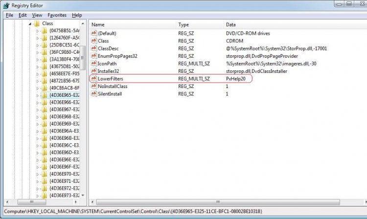

t would reinstall itself and get error code 39 telling me the driver is corrupt or missing.
But error code 39 is very simple repearable -there are only UpperFilter,LowerFilter trouble in key HKLM\SYSTEM\CurrentControlSet\Control\Class\{4D36E965-E325-11CE-BFC1-08002BE10318} and nothing more
Error code 10,19,31,39,41 are fully reapeareble by KB314060 and nothing more is required

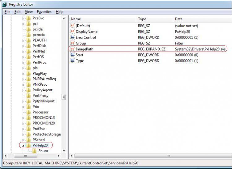

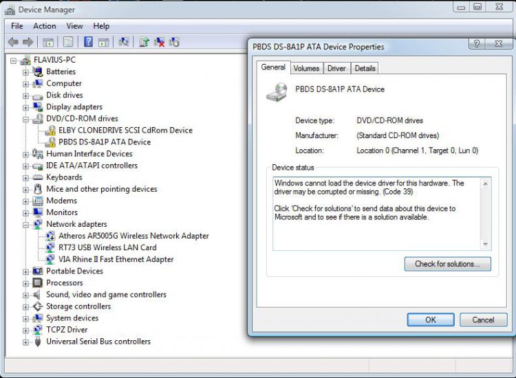

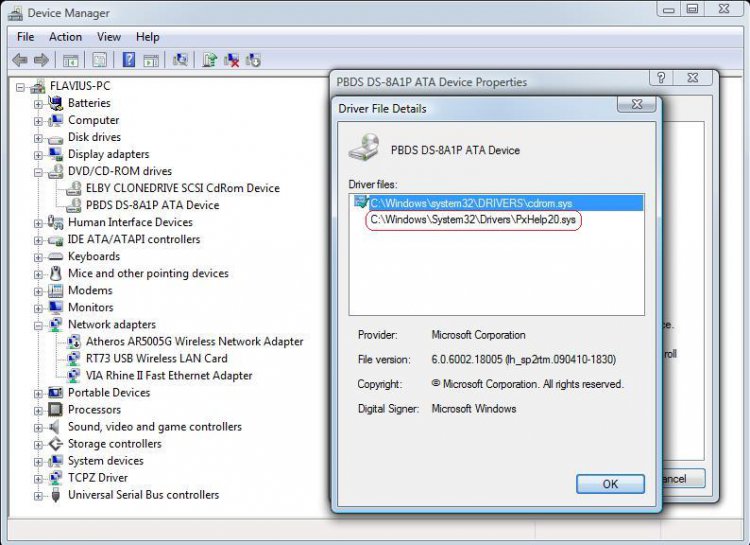

You had hang undesire filter driver hanged by DVD.I fought many times with these errors like you :sleepy:.Even I made keepsake.Look these photos (before error an with error):
When this kind of error appear the hanged driver is not visible in device manager -you only see it in registry
You can read entries in UpperFilter/LowerFilter ->these coresponds to driver service which is hanged.Of course you have to find this driver service in HKLM\System\CurrentControl\Set\Services
For example in my image
LowerFilter=PxHelp this means driver service is PxHelp and service key is
HKLM\System\CurrentControlSet\Services\PxHelp20 and then easy to read & locate driver.
Of course PxHelp20.sys is non-system driver
HKLM\System\CurrentControlSet\Services\PxHelp and then easy to read & locate driver.
Of course PxHelp.sys is non-system driver
