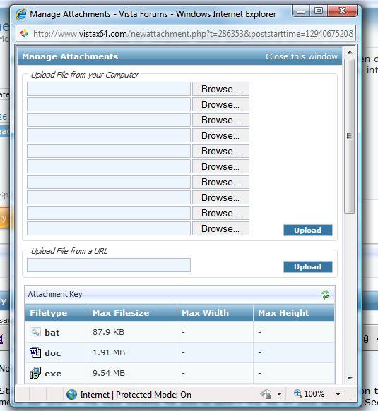

Start to edit a new message in the forum. Once the text is completed, click on the paper clip & a file menu will open in the view window for you to select the file on your desktop. See picture.
now click on one of the "Browse" buttons & find & select the file on you desktop. once the file name appears in that window, click upload, again when the file name appears in the window (Different location, middle to bottom of the screen), then close the window.
Now all you have to do is post your message.
