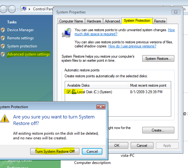

try resetting your restore points,
right click on my computer and go to properties,
click advanced system settings>system protection, now remove the check mark in c drive, click on turn system restore off.
Restart your computer.
right click on my computer and go to properties, click advanced system settings>system protection. now put a check mark on c drive and turn on your system restore.
restart your computer and try :)
