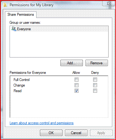

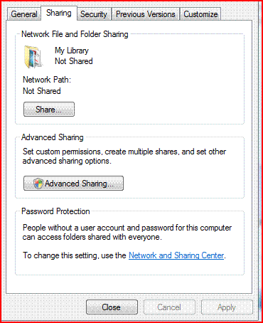

Thinking that maybe the network sharing was impacting this, I then removed the share capability AND the security settings from the shared root. Repeated take ownership; but no change.
