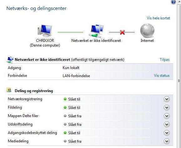

As the picture also shows, it does indeed have red X between network and the internet. However when clicking on the Internet globe it just opens my browser, but I'm not able to load any pages.

Try clicking on the red x. My wife's system had the same problem and I clicked on one or the other and it fixed it.
When you open the Network and Sharing, click on Diagnose and Repair. Does that help?

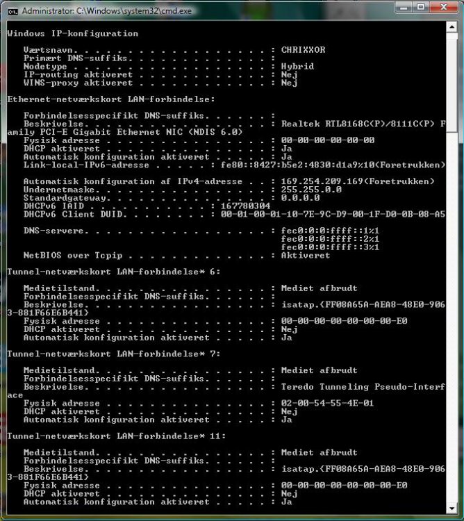

169.254.xxx.xxx is an autoconfiguration IPv4 address when the host cannot receive a DHCP offer. Can you please temporarily disable any anti-virus and firewall applications and then test connectivity as these could be the cause.
Also can you please boot the machine into safe mode with networking and test connectivity to remove the possibility of a third party application being the cause.
