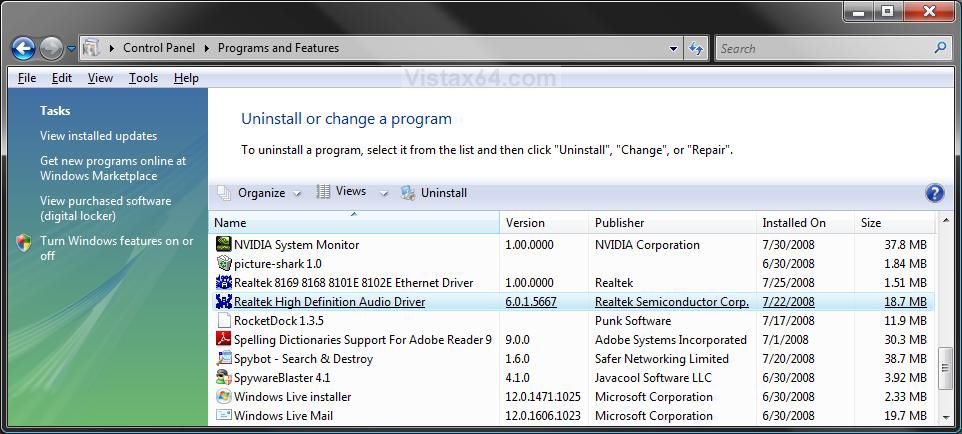

Through Programs and Features
NOTE: This will only uninstall the device driver software and not the device itself from Device Manager. You would use this option if you wanted to install another device driver version afterwards for the device.
1. Open the Control Panel (Classic View).​
2. Click on the the Programs and Features icon.​
3. Look to see if the device driver is listed. (See screenshot below step 4)​
A) If it is, then right click on the listed device and click Uninstall, then Yes to confirm.​
NOTE: Sometimes, you will get a notice to restart the computer to finish uninstalling the driver. If you do, then click on Yes to restart the computer when prompted.​
B) If not, then use OPTION TWO below.​
4. Close the Programs and Features window.​
5. If a generic driver for the device is included in Windows, then Windows will automatically install this generic driver for the device if the device is still connected.​

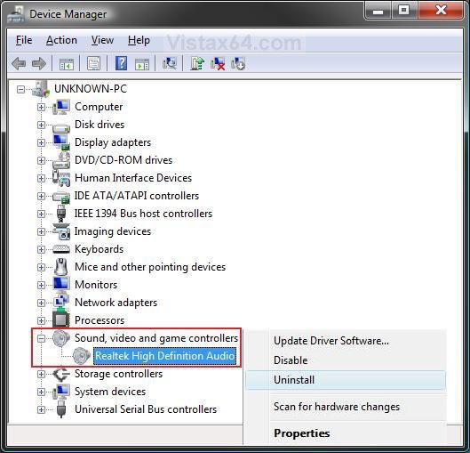

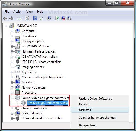

4. Click on the + sign next to the device you want to uninstall to expand it. (see screenshot below step 5)​
5. Right click on the listed device and click on Properties.​
NOTE: You can also click on Uninstall and go to step 8 instead.​

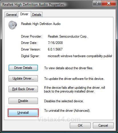

6. Click on the Driver tab. (see screenshot below step 7)​
7. Click on the Uninstall button.​

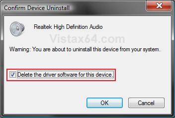

9. To Uninstall Both the Device and Device Driver
NOTE: This will uninstall both the device and device driver software installed for the device.
A) Check the Delete the driver software for this device box.​
NOTE: If you do not have this option, then only the device will be uninstalled. Go to step 10.​
B) Click on OK.​
NOTE: Sometimes, you may be prompted to restart the computer to finish uninstalling the driver. If you do, then click on Yes to restart the computer.​

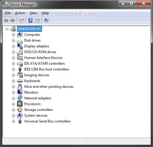

10. Device Manager will now no longer have the device listed. (see screenshot below)​
11. Close Device Manager. (see screenshot below step 5)​
