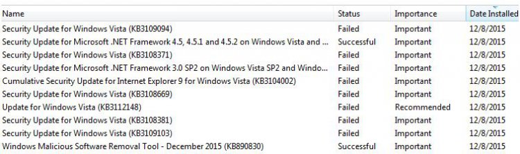

When I came back to my computer after installing 10 updates this evening and then restarting, I had a screen stating: Updates were not configured correctly. Reverting changes. Please do not restart your computer.
As you can see by the screenshot below, there were only two updates that didn't fail.

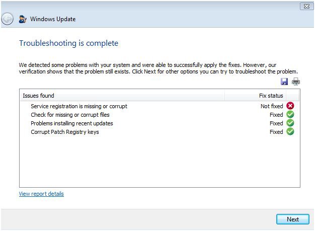

I Googled and researched a little. I ran the Microsoft FixIt for Windows Update and it reported as shown here:

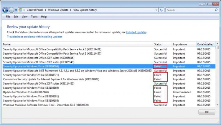

Hi Nikilet:
I had the same "Updates were not configured correctly. Reverting changes. Please do not turn off your computer" message when I ran the December 2015 Patch Tuesday updates on my 32-bit Vista machine today (09-Dec-2015). Windows Update found a total of 15 available updates for my machine (13 Important, 1 Recommended - I declined 1 Optional update for Silverlight) and 7 updates for Vista and IE were rolled back and marked as Failed.

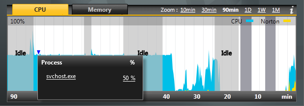

Just FYI, many other Vista users have reported that Windows Update seems to get stuck at "Checking for updates..." for long periods of time, and this problem dates back to the August 2015 Patch Tuesday updates - see my screenshots in ScousaJAY's thread windows update just seems to hang while checking. This month's Windows Update took a full hour on my machine before it finally finished checking and presented a list of available updates. The screenshot below shows my CPU stuck at 50% (i.e., complete saturation of one of my dual cores) by the wuauserv service running under svchost.exe until the 40 min mark, and two re-boots (dark grey bands) around the 15 and 5 min marks.
Thanks for letting me know you were eventually able to get your updates to install successfully. I'll try another manual Windows Update tomorrow and post back if I run into any further problems.
