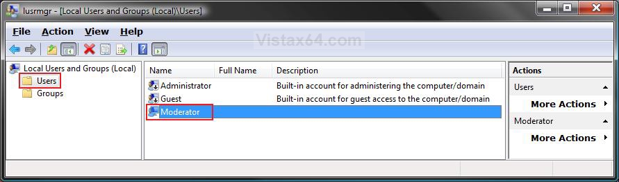

1. Open the Local Users and Groups manager.​
2. In the left pane click on the Users folder. (See screenshot below)​
3. In the middle pane, right click on the user account's name that you want to hide or unhide and click Properties. (See screenshot above)​
NOTE: The accounts with the arrow pointing down in the user icon are hidden. The ones without a arrow are unhidden.​

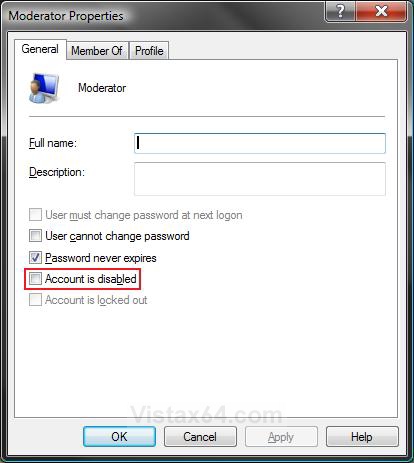

4. To Hide a User Account
A) Check the Account is disabled box. (See screenshot below step 5)​
B) Go to step 6.​
5. To Unhide a User Account
A) Uncheck the Account is disabled box. (See screenshot below)​
6. Click on OK. (See screenshot above)​

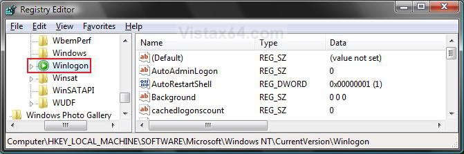

3. In regedit, navigate to the location below. (see screenshot below)​

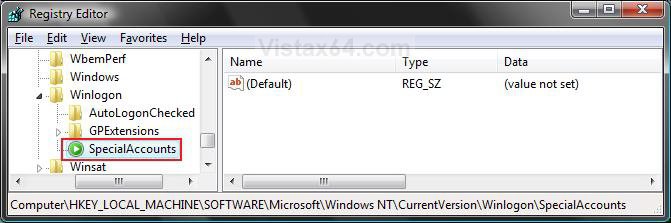

HKEY_LOCAL_MACHINE\Software\Microsoft\WindowsNT\CurrentVersion\Winlogon

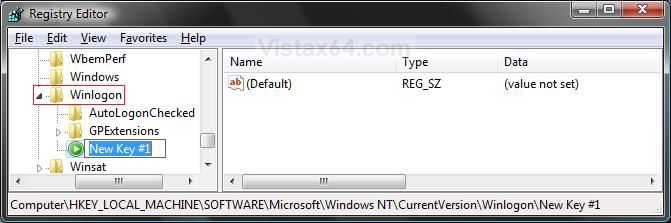

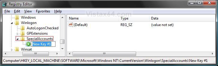

4. In the left pane, right click on Winlogon and click on New and Key.​
5. Type SpecialAccounts and press Enter. (See screenshot below)​

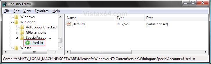

6. In the left pane, right click on SpecialAccounts and click on New and Key. (See screenshot below)​

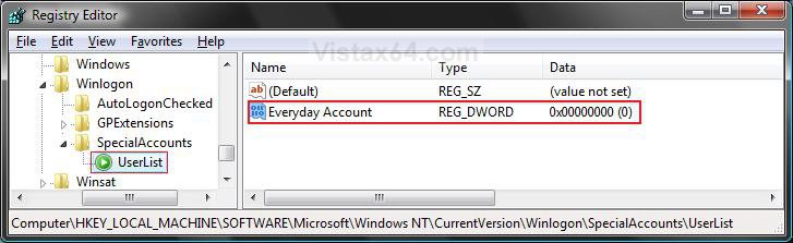

7. Type UserList and press Enter. (See screenshot below)​

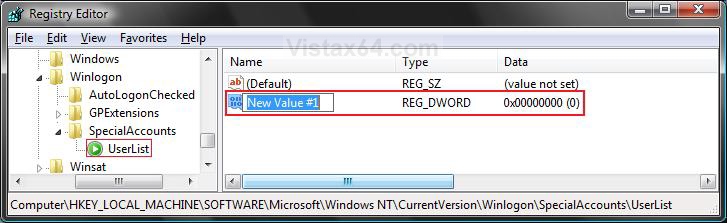

8. In right pane of UserList, right click on a empty area and click on New and DWORD (32bit) Value.​
9. Type in the name of the user account that you want to hide and press Enter. (See screenshot below)​
NOTE: For example: My user account name is Everyday Account.

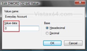

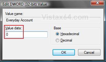

10. In the right Pane, right click on the user account name and click on Modify. (See screenshot below)​
11. To Hide the User Account
A) Type 0 (number zero) and click on OK. (See screenshot below)​
WARNING: Do not hide your only Administrator account. Always leave one unhidden so you can make changes to Vista. If you did this by mistake, then boot into Safe Mode and unhide your Administrator account.​
