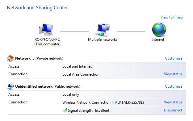

hi yep, they are both set to automatic. what installation cd? if you mean the windows vista disc....no. i honestly dont even remember getting one if i did.... lol
I know you tried the first suggestion in the error message you posted above. Also try the other two, first try the first option and if that doesn't work, try the second option (as noted in the attachment concerning the Wireless Network Connection).
Assuming neither work, then I recommend you create an entirely new wireless connection as if you were starting from scratch (but making absolutely sure you're using the correct settings) and see it you can connect with this new connection. If so, switch to the new connection and the problem is solved. If not, read on.
When you connect, do you have separate connections to the local network and to the broadband connection or is the modem configured to automatically connect to the internet when you connect wirelessly? From IPCONFIG, it looks like the connection is automatic but I want to confirm that.
When you connect by Ethernet cable, do you go through the router or do you connect directly to the modem? If directly to the modem, try connecting through the router to verify that it works when the router is in the equation.
Do you have any other devices connected wirelessly to this router and that are functioning? If so, I'd have to guess the router is working fine (but the computer settings may not be correct). If not (meaning there are no other devices), do you know anyone with a wireless laptop you can invite over to connect through your router and confirm they can do so (and hence the router is properly transmitting wirelessly)? Do you have any other devices connected by cable to the router assuming you don't do that when connecting by cable yourself (I'm trying to verify the router itself, not just the wireless part, is working)?
If you're using a Firewall and/or other Security Software, temporarily disable it all and see if you can connect. I want to confirm no security-related software is interfering with the connection.
Also to verify no interference from other programs, try a clean boot http://support.microsoft.com/kb/929135. If the problem goes away then it's just a matter of tracking down the culprit causing the problem. Follow the procedures in the article. Once found, delete, remove, deactivate, or uninstall it. Once done be sure to reset Vista back to normal status as explained in the procedures. If the problem occurs in clean mode then just restore the system to normal status and reboot - this solution is not going to work.
Here's an article on troubleshooting wireless network connections (again with helpful links): http://windows.microsoft.com/en-US/windows-vista/Troubleshoot-network-connection-problems. Please go through it to see if anything rings a bell or seems wrong. Either follow the correction instructions or post back explaining the anomaly and maybe it will help us ID the problem.
