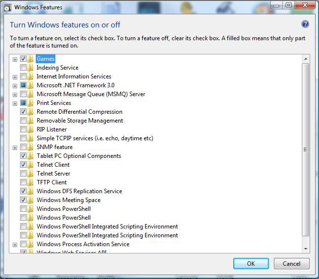

Check the Vista PC's Windows features to see if the service is active.
