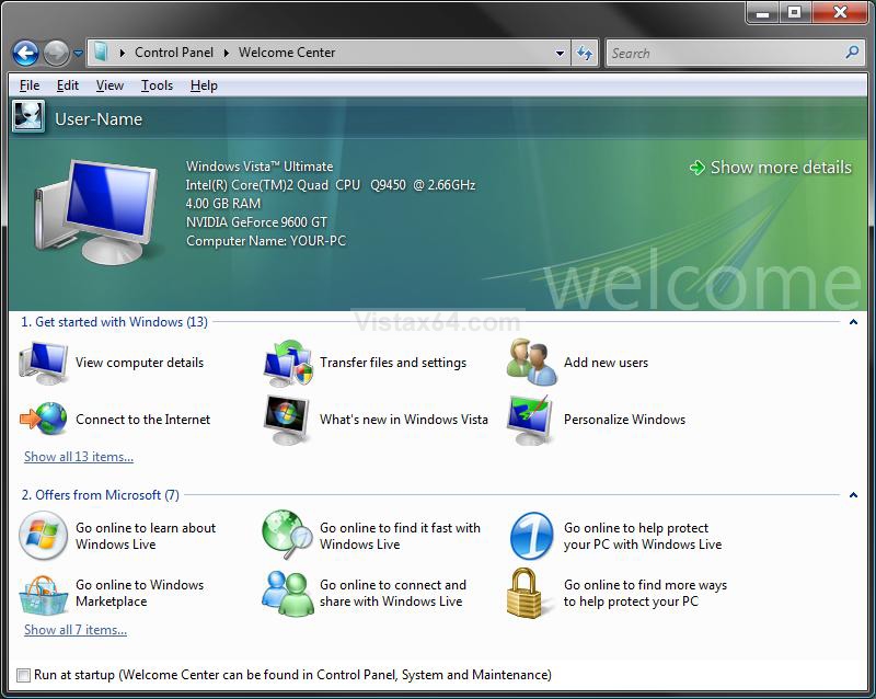

EXAMPLE: The Welcome Center

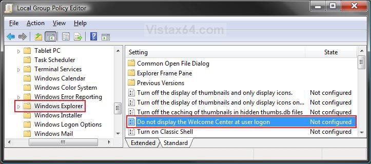

2. In the left pane, click on User Configuration, Administrative Templates, Windows Components, and Windows Explorer. (See screenshot below)​

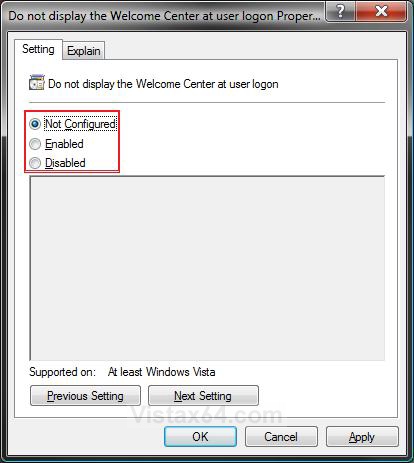

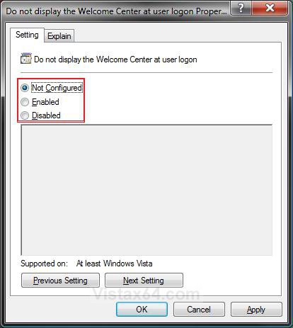

3. In the right pane, right click on Do not display the Welcome Center at user logon and click on Properties. (See screenshot above)​
4. To Enable the Welcome Center to Run at Startup
B) Go to step 6.​
5. To Disable the Welcome Center to Not Run at Startup

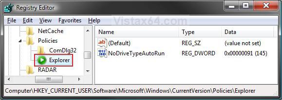

Manually in Registry Editor
1. Open the Start Menu.​

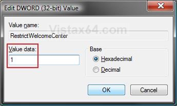

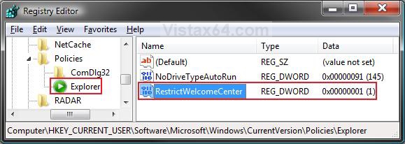

A) In the right pane, right click on a empty area and click on New and DWORD (32-bit) Value. Type RestrictWelcomeCenter and press Enter. (See screenshot below)​
B) Right click on RestrictWelcomeCenter and click on Modify.​
C) Type 1 and click on OK. (See screenshot below)​
D) The registry will now look like this. (See screenshot below)​
E) Go to step 7.​
6. To Enable the Welcome Center to Run at Startup
A) In the right pane, right click on RestrictWelcomeCenter and click on Delete. (See screenshot above)​
B) Click on Yes to confirm the deletion.​
7. Close regedit.​
