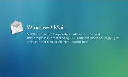

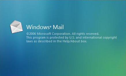

This will show you how to enable or disable the Windows Mail splash startup screen.
This can save you a few seconds off of the loading time of Windows Mail with it the Splash Screen turned off.
EXAMPLE: Windows Mail Splash Screen

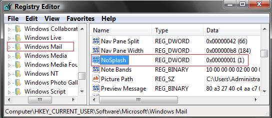

1. Open the Start Menu.​
HKEY_CURRENT_USER\Software\Microsoft\Windows Mail
5. See if you have NoSplash in the right pane.​
6. If yes, then go to step 9.​

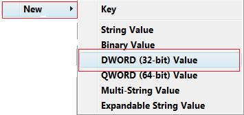

7. If not, then right click on a empty area in the right pane and click on New and DWORD (32-bit Value). (See screenshot below)​
8. Type NoSplash and press Enter.​

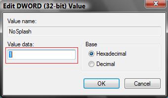

9. In the right pane, right click on NoSplash and click on Modify.​
10. To Disable the Splash Screen
NOTE: Also look in this registry location for the NoSplash entry as well:
HKEY_LOCAL_MACHINE\SOFTWARE\Microsoft\Windows Mail
A) Type in 1 and click on OK. (See screenshot below)​
11. To Enable the Splash Screen
A) Type 0 (number zero) and click on OK.​
12. Close regedit.​
13. Log off and log on, or restart the computer to apply.​
