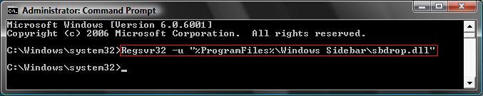

2. In the elevated command prompt, type: (See screenshot below)​
A) For 32 bit and 64 bit Vista:
Regsvr32 -u "%ProgramFiles%\Windows Sidebar\sbdrop.dll"
B) Also Type for 64 bit Vista Only:
Regsvr32 -u "%ProgramFiles(x86)%\Windows Sidebar\sbdrop.dll"
C) Press Enter after A and/or B.​

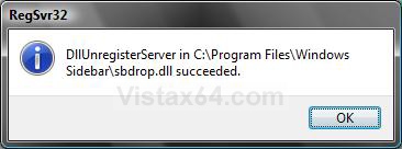

3. Click on OK. (See screenshot below)​

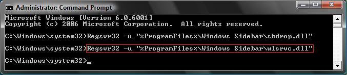

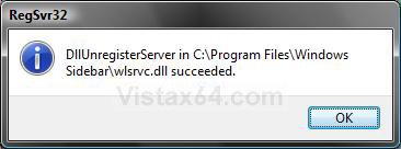

4. In the elevated command prompt, type: (See screenshot below)​
Regsvr32 -u "%ProgramFiles%\Windows Sidebar\wlsrvc.dll"
Regsvr32 -u "%ProgramFiles(x86)%\Windows Sidebar\wlsrvc.dll"
5. Click on OK. (See screenshot below)​

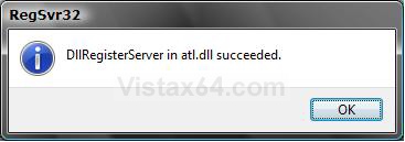

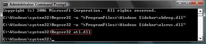

6. In the elevated command prompt, type Regsvr32 atl.dll and press Enter. (See screenshot below)​
7. Click on OK. (See screeshot below)​

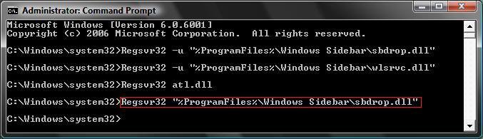

8. In the elevated command prompt, type: (See screenshot below)​
Regsvr32 "%ProgramFiles%\Windows Sidebar\sbdrop.dll"
Regsvr32 "%ProgramFiles(x86)%\Windows Sidebar\sbdrop.dll"

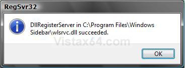

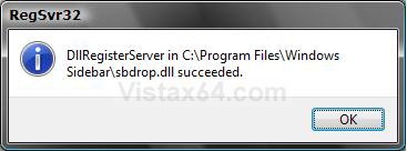

9. Click on OK. (See screenshot below)​

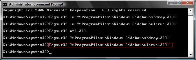

10. In the elevated command prompt, type: (See screenshot below)​
Regsvr32 "%ProgramFiles%\Windows Sidebar\wlsrvc.dll"
B) Also type for 64 bit Vista Only:
Regsvr32 "%ProgramFiles(x86)%\Windows Sidebar\wlsrvc.dll"
11. Click on OK. (See screenshot below)​
