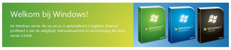

Hey Noel,
In the beginning I also thought of a counterfeit installation, especially since my dad's computer guy was a bit shady when I asked him about his Microsoft partnershift, but I already ran an MGA on most of those, and all came out clean.
I haven't run an MGA on this machine yet, but I did activate Windows by phone less than three hours ago.
Here's the MGA;

I didn't use online activation yet, let's see what happens.
Mhm, expected it to unvalidate, but instead it validated smoothly, heh.
Here's a screenshot from the website, it's in Dutch, but roughly translated it says "Welcome to Microsoft! The version of Windows installed on this machine is valid."
Time to reinstall the Intel storage drivers?
