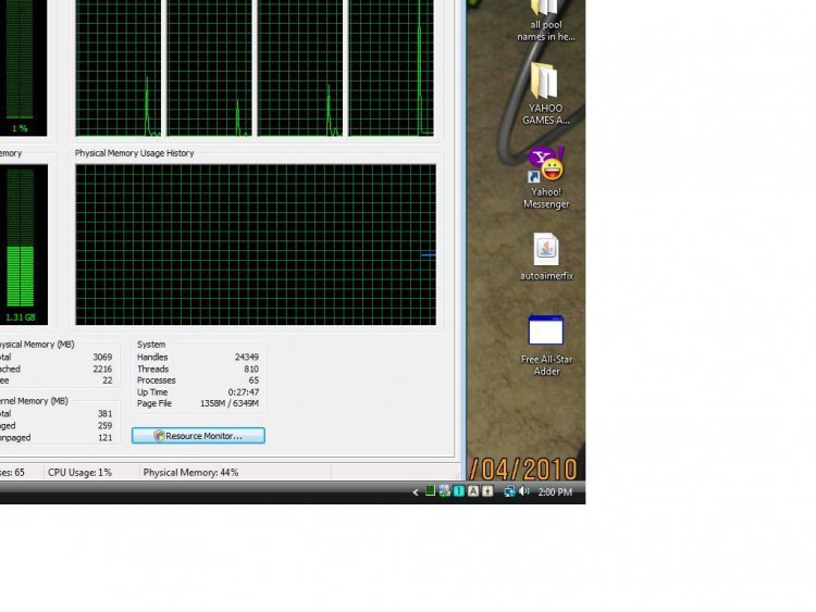

ok i have done both , still 2.00 minutes to get on, 3 minutes to get on the net,
the gb has dropped as you can see i dont no if that was removing the two items from start up ..
im really not sure what else i can do to drop the (gb) down as im sure it was running at one stage on 1.12
Ill look for more start up items to remove, tomorrow. Now its time for bed. 12:15 here. As you see it takes time. We have your ram usage down abit. We will speed it up, too
