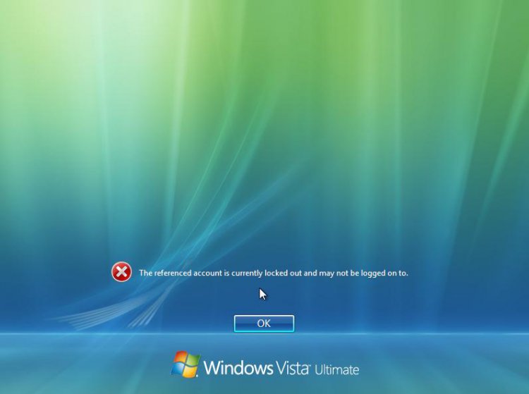

EXAMPLE: A User Account Locked Out at Logon

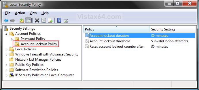

2. In the left pane, under Security Settings, click on the arrow next to Account Policies to expand it. (See screenshot below step 3)
3. In the left pane, click on the Account Lockout Policy folder.

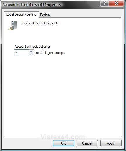

A) In the right pane, right click on Account lockout threshold and click on Properties. (See screenshot above)
B) Type in a number between 0 and 999 failed attempts you want allowed and click on OK. (See screenshot below)

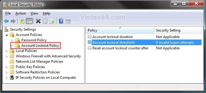

NOTE: Typing in the number 0 will disable Account Lockout and set steps 5 and 6 back to the default setting of Not Applicable.

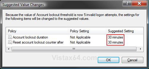

C) Click on OK in the Suggested Value Changes window. (See screenshot below)
NOTE: You will not see this window unless you are changing the number of attempts from step 6B from 0 or to 0. You can still manually change these Suggested Settings for steps 5 and 6 below if you do not want them set at 30 minutes.
D) The setting will now look similar to this. (See screenshot below)

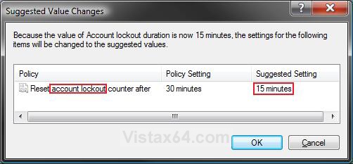

NOTE: You will not see this window unless you are changing the number of minutes to a number lower than what they are set for in step 6. You can still manually change these Suggested Settings for step 6 below if you do not want it set as the same as step 5B.

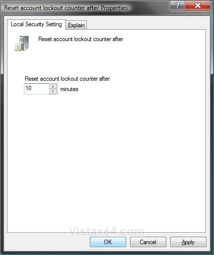

A) In the right pane, right click on Reset account lockout counter after and click on Properties. (See screenshot below step 3 or 4D)
B) Type in a number between 1 and 99,999 minutes you want before counter reset and click on OK. (See screenshot below)
NOTE: This must be less than or equal to the minutes set for the Account lockout duration in step 5B.
7. When done, close the Local Security Policy window. (See screenshot below step 3 or 4D)

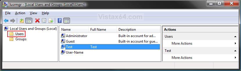

A) Open the Local Users and Groups manager.
B) In the left pane, click on Users. (See screenshot below)

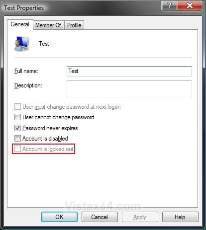

C) In the middle pane, right click on the locked out user account you want to unlock and click on Properties.
D) Uncheck the Account is locked out box and click on OK. (See screenshot below)
E) When done, close the Local Users and Groups window. (See screenshot below step 8C)

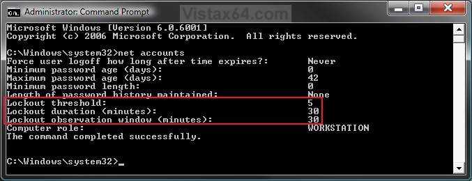

A) In the command prompt, type net accounts and press Enter. (See screenshot below)
NOTE: The listed items boxed in red is the current status of the Account Lockout settings.
