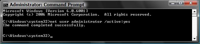

2. To Enable the Hidden Built-In Administrator Account
A) In the elevated command prompt, type the command in bold below and press Enter. (See screenshot below)​
net user administrator /active:yes

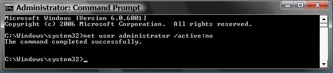

3. To Disable the Hidden Built-in Administrator Account
WARNING: Make sure you are not logged into the built-in Administrator account when trying to disable it. You must be logged into a normal administrator account to do this instead. It will not work if you try to disable the built-in Administrator account while you are still logged on to it.​
net user administrator /active:no
4. You will get the message, The command completed successfully. If not, repeat the step.​

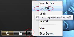

6. Log off (in Start Menu) and you will see your new built-in Administrator account next to your current account(s).​
