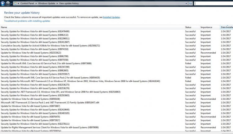

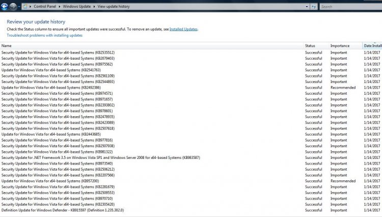

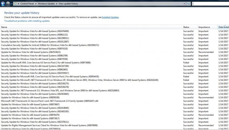

Hi all - first my apologies for another update thread, but am at my wits end. I have spent 2 days reading the threads here and on Microsoft regarding the Vista update issues and doing as much troubleshooting as possible with no luck. I previously fixed a Vista laptop with this issue but this one is proving much more stubborn.
Working with Vista Home Premium 64 bit on a freshly restored dv4-1435dx (received it with SP1 and applicable updates). All was working fine at that point as far as updating. I ended up with a manual update of SP2 as it would not auto update that. While it completed fine, and says SP2 in my system info -- strangely, my update list shows that failed 5 times, but no entry for successful. Not sure if this is a problem or not. If I go to install SP2 again it says already installed.
Then got the dreaded checking for update issue that wouldn't stop. After researching -- I tried every single suggestion, updating each item with the standalone updater or link one by one, turning off AU, turning off AV, restarting each time, adding again and they ALL have installed without any problem. (Have IE7 installed so leaving the IE9 one out.) Just finished installing the system update readiness tool and that is where I am now.
Because there are so many suggestions and I keep finding new links, installers, updates, and they change over time, I'm afraid I may have put some older ones or not gone in the correct order. I can install anything manually but still no luck when I try to do automatic updates - left it for 15 hours and nothing.
Also, I did the scannow test, and it found some errors that said "could not be fixed" or something like that - I have the log file from that but not sure how to correct this or if that is necessary
Any help would be much appreciated. I have old legacy hardware for work that must use XP or Vista and I have to keep up with this for that reason on a few units :(
Thanks!!!
Here is the entire list of updates as of right now:

CRAP! Entire day updating then it seems to get stuck and restart - installing upon boot, all looked ok, now this:
"Updates were not configured correctly. Reverting changes. Do not turn off your computer."
NOO! Googling brings up lots of suggestions to restore or reinstall....do I really have to do this?
Ugh I knew it was too good to be true :(

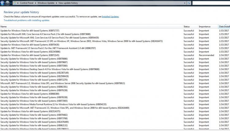

Ok, hours and hours later it restarted and I see that about 20 updates were succesful and the rest failed!
Went back and tried to install KB3198234 (and the one that a thread said replaced it in Dec I think) but BOTH said "does not apply to your system" - couldn't find either of those numbers in my install list though....
Just put it back to checking and will leave it overnight....don't know if I just made it worse with those random ones installing or not :(
Interestingly though, the 5 ones I managed to get on successfully when the updates started working again and found the 190 -- those are all still there; theoretically it should allow this to restart again but no idea if something else got messed up with the interruption
Will update when I get up and see if anything changed.

Ahh I apologize, I probably wasn't clear enough. I never actually got to install KB3198234. While I was typing the reply to you suggesting that, the laptop started updating 190 items :) So I never got there. Then, the whole laptop froze (light white screen, cursor round and turning) and restarted, cutting the update process off in the middle.
I am thinking that cutting off caused the "not configured correctly" but of course can't be sure. When the laptop restarted, I did go and try to manually install KB3198234 as I hadn't gotten to it yet and that's when it said "does not apply to your system." So, it's still not on and I can't get it on. But you're right, it didn't cause the error, since it wasn't actually installed :)
Anyway, just got up and the laptop had restarted, and the remaining 136 updates were ready to install. Hopefully they will go through okay...and it was just the freezing that caused the blip. I will update in a bit...

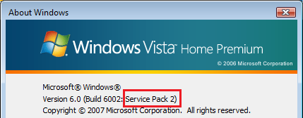

Hi NYCNY:
Just confirm first that you have Vista SP2 installed. click the Start button, choose Run..., and enter the command "winver" (without the quotes) . If you have the latest service pack the pop-up should show that Service Pack 2 is installed.
Most Vista SP2 users are currently having difficulties running Windows Update, and affected users experience "Checking for updates..." hangs and slow Windows Updates that can run for several hours (or even days) without throwing an error message. ScousaJAY's thread windows update just seems to hang while checking is the most active thread in this board and many Vista SP2 users post regular feedback there.

Thanks - yup, says sp 2 build 6002 :)

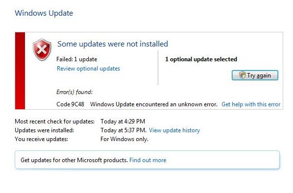

Update: All of the final 136 updates installed sucessfully! Restarted, and 2 more came up - one important (KB2522422) which installed fine, but the second one without a number "Windows Internet Explorer 9 for Windows Vista for x64 based systems" failed with error 9C48. Restarted and tried again, and failed.

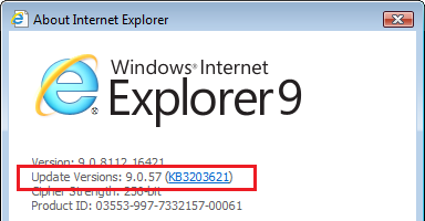

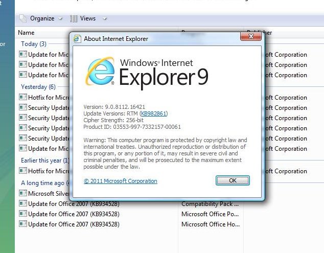

Googling 9C48 mentions some corrupt files/updates for IE9...but not exactly sure what to try now.
The version of IE on now is 9.0.8112.16421...so it seems there's an issue where it's already on, but the update thinks it's not? I see the entry where it successfully installed yesterday.
Hi NYCYC:
All Vista SP2 users with IE9 have the same build 9.0.8112.16421 - you need to check the Update Version to see if IE9 is fully patched with the latest cumulative update. Open IE9 and go to Help | About Internet Explorer - if your IE9 browser is fully patched you should have the latest Update Version 9.0.57 (KB3203621). If you have an older version, post back and I'll provide a link for the standalone .msu installer.

Hi NYCYC:
32-bit Vista Home Premium SP2 * Firefox v51.0.1 * NIS v22.9.0.68 * MBAM Premium v2.2.1
Ahh, thanks - it's KB982861. I located the vista 64 bit installer for kb3203621 but it just gave me the "does not apply to your system" .....

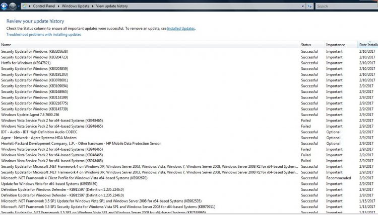

Restarted and everything else looks great, just this left:

Hi NYCNY:
I'm not clear from the image you posted, but is the only update that is failing with an error 9C48 an Optional update? When you click the Review optional updates link, what KB number or hardware driver is Windows Update trying to install? Does Help | About Internet Explore show that IE9 is patched to Update Version 9.0.57 (KB3203621) since you re-booted? If IE9 still won't update please post a screenshot of the pop-up window you see when you go to Help | About Internet Explorer, and let me know the URL for the download link you used when you downloaded the 64-bit standalone .msu installer for KB3203621 that threw the "not applicable" warning.
If your Vista SP2 OS is now fully patched with all Important and Recommended updates as of the January 2017 Patch Tuesday updates then security update KB3216775 (MS17-004: Description of the security update for Local Security Authority Subsystem Service: January 10, 2017) should be installed on your system. Search your installed updates at Control Panel | Programs and Features | View Installed Updates and see if KB3216775 is installed. When searching, enter the full KB number in the search box (e.g., "KB3216775" and not a partial string like "3216775").

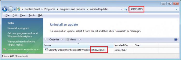

Re: Another update stuck thread (sorry!) all tips not working on this on this laptop.
Yes, everything else is updated and nothing else shows - it searched fully and only this one optional update is there.
Reviewing that update, it has a description but no number, just says size 35.5mb and published 5/31/2011
IE9 patch is still KB982861 after reboot
Yes I found KB3216775 successfully installed in the list from 2/9 :)
Here's the link I used - Microsoft Update Catalog
Pic attached
Thanks for your help with all of this !!

Also not sure if it matters, but the update starts installing and goes for about 20 seconds, then changes to failed 9C48
