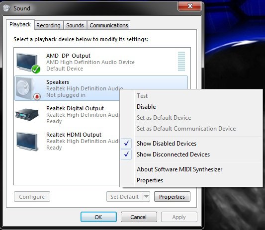

4. Right click on a empty area and click on Show Disabled Devices.​
5. You will now see the disabled audio devices with the arrow pointing down on them. (See screenshot below)​
NOTE: These audio devices will vary depending on the installed audio card or chip you have.​
6. Right click on each listed disabled audio device that you want to enable and click on Enable. (See screenshot below)​
7. You will now see this when the audio devices are enabled. (See screenshot below)​

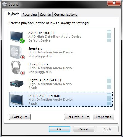

I have a similar problem to fannie. Can you please provide me solution.
I have Intel High Definition HDMI sound card installed and is visible in Device Manager.
But the same is not showing up in Manage Audio devices > Sound.
Any pointers how to add the HDMI card in Sounds?
Hello Karthik, and welcome to Vista Forums.
That would most likely be listed in the Playback tab in Sounds as a HDMI device instead.

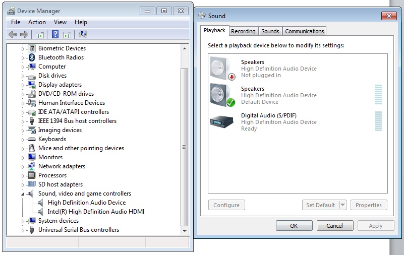

Thanks. Attached is the snap shot i was talking about.
In Device Manager, i can see Intel High Definition Audio HDMI
In Sounds > Playback, Intel High Definition HDMI is not visible.

Karthik,
Sure it is. The "Speakers" that you currently have set as default has "High Definition Audio Devie" under it as it's desciption. :)
