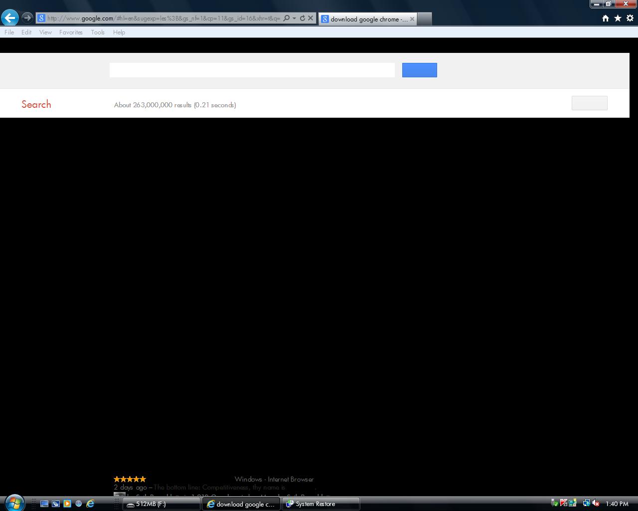

Everything boots up 100% fine, navigation through files & folders - perfect. The computer is not slow. The only program is going into Internet Explorer OR Google Chrome, getting out on the web.
When I open Internet Explorer, I get this:
That little line is a cursor flashing. When I type something, the cursor moves as I am typing, as shown in this next screen shot:

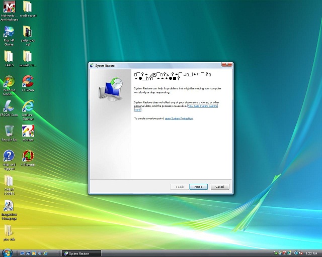

I tried doing a system restore, and no matter what restore point I chose, It wont restore. But in the next screen shot, see how the "font" in the very top?

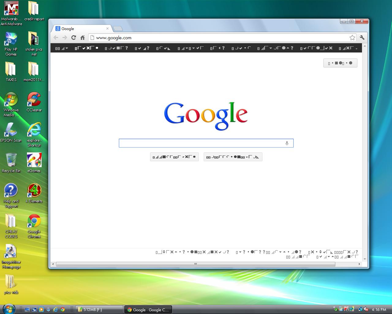

Now, google chrome worked - but those fonts & odd characters? It happens in Google Chrome. I can't read anything because of it.

Thanks. Just went into safe mode, and thought I should see if the problem still happens in safe mode. Now in safe mode, it doesn't come up completely black, but it does come up PURE WHITE now. And then I went to do a system restore, and still get the funky characters at the top, and unsuccessful.

I reinstalled google chrome, and still get the funky characters:

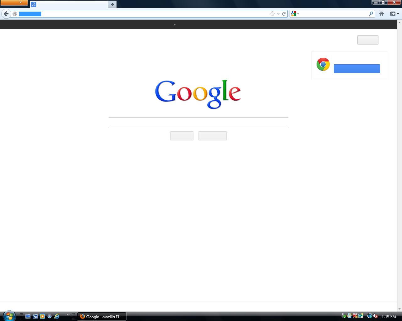

Then I tried to install Mozilla, and even that's screwed up:
I typed www.google.com in the address bar, and it comes up blank, but actually does go there. So I just can't see what I am typing.
