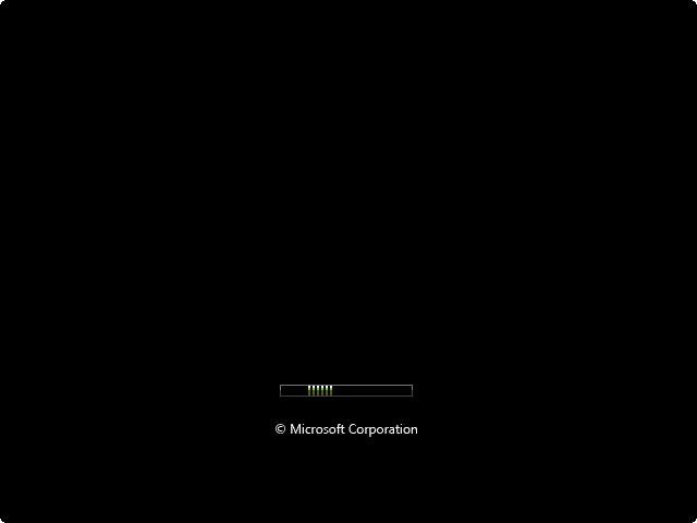

How to Change the Default Boot Screen in Vista
The boot screen is the screen that displays during the bootup (startup) of Vista before the logon screen (welcome screen) and the desktop.
Running the sfc/ scannow command will reset the boot screen back to default.
If you wanted to run chkdsk at startup or the Memory Diagnostic Tool and you have changed the default boot screen, then you will need to temporarily change the boot screen back to the default boot screen to be able to see what is happening first to be able to see what is happening when they run at startup.
EXAMPLE: Default Vista boot screen

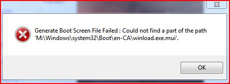

I give up on Vista Visual Master. I get the en-CA popup when I try to generate the file but I have changed the default input language to en-US as per the instructions.
It would help if the application had its own help files.
The strange thing is that it has changed my boot screen to Aurora despite the failure (which I don't like) but no change to the loogon screen.
Addendum: all's well now - realised that it's the logon screen changer I need, not this one....LOL....Doh!!

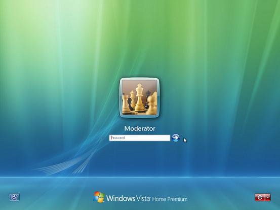

Hello Erik, and welcome to Vista Forums.
While both programs change a screen image to one you want instead, the boot screen (top) and log on screen (bottom) are two completely different screens. :)

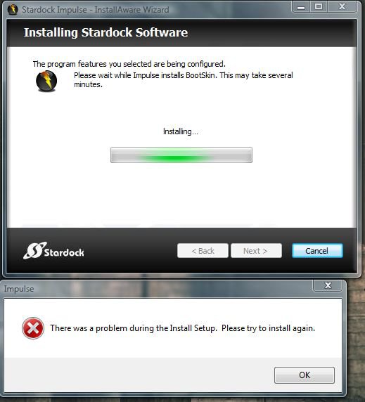

When installing option 1 I get this during install but I haven't ran the program to change my screen. I also ran it as admin too. Also the program runs ok but as I said I haven't changed the screen.
