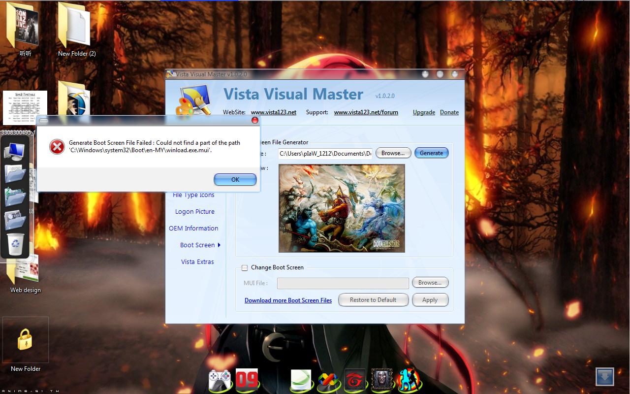

cant change.it say cant generate.....
Said:Could not find a part of the path C:\Windows\System32\Boot\en-MY\winload.exe.mui
Hello 901212, and welcome to Vista Forums.
Did you run the program as an administrator? If you did, then you might send feedback to the program's website to see if they can determine if it may be a bug. :(
