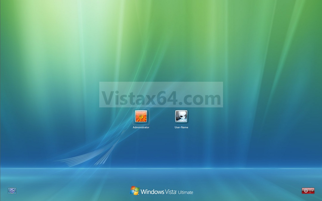

EXAMPLE: Built-in Administrator Account at Log on
NOTE:
Top screenshot is the default name, and bottom screenshot is renamed.

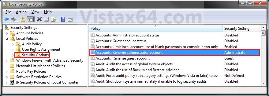

1. Open the Local Security Policy editor.​
2. In the left pane, expand Local Policies, and click on Security Options. (See screenshot below)​

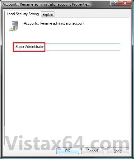

3. In the right pane, right click on Accounts: Rename administrator account and click on Properties. (See screenshot above)​
4. Type in a name you want instead that has not ever been used by any other user account on the computer, and click on OK. (See screenshot below)​

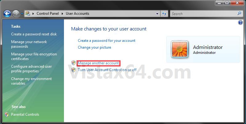

2. Open the Control Panel (Classic View).​

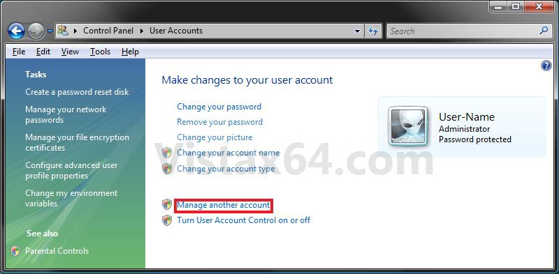

3. Click on the User Accounts icon.​

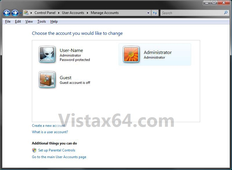

4. Click on the Manage another account link. (See screenshots below)​
NOTE: The top screenshot is while logged in to the built-in Administrator account. The bottom screenshot is while logged in to a default administrator account.​
5. If prompted by UAC, then click on Continue.​

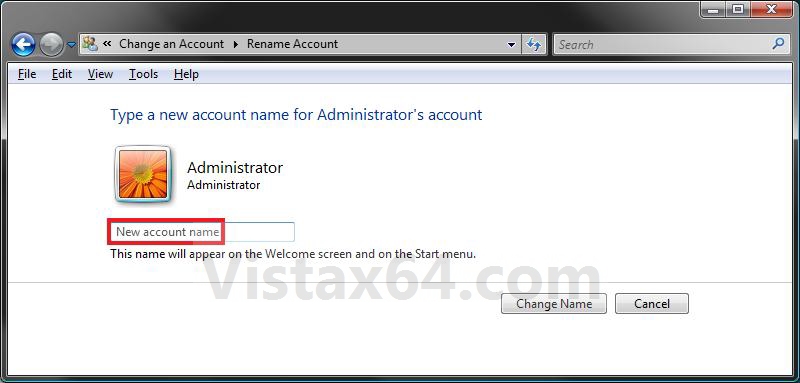

6. Click on the listed built-in Administrator account. (See screenshot below)​

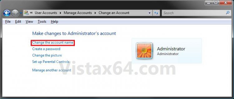

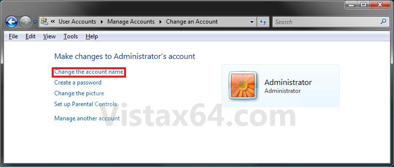

7. Click on the Change the account name link. (See screenshot below)​
8. Type in a name you want instead that has not been used by any other user on the computer, and click on the Change Name. (See screenshot below)​

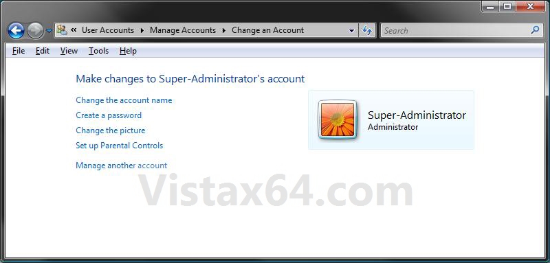

9. The built-in Administrator account is now renamed. Close the User Account window. (See screenshot below)​

10. You can now log off or switch users to see built-in Administrator account's log on icon with the new name in the log on screen. (See screeenshot below)​

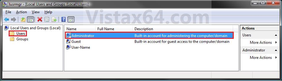

1. Open the Local Users and Groups manager.​
2. In the left pane click on Users. (See screenshot below)​

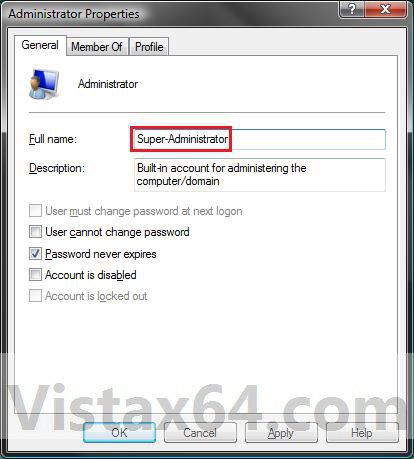

3. In the right pane, right click on Administrator and click on Properties. (See screenshot above)​
4. In the General tab and to the right of Full name, type in a name you want instead that has not been used by any other user on the computer and click on OK. (See screenshot below)​
