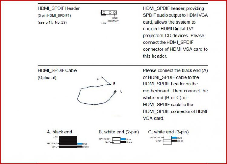

ok just a run down of what you have done, connected your tv to your pc via DVI to HDMi adaptor and audio is connected via stereo jack, is there a function on your television that can have 2 audio sources from different inputs, if not, you can get audio through your HDMi input by connecting the SP/DIF to the graphics card,
ive included a snapshot of your motherboards user manual information on HDMi SPDIF connection. i have also included the PDF document for your motherboard.

Yes it does. You need a cable just like the one MrNeeds pictured, and it needs to connect to the SPDIF connector on both the video card and on the motherboard. No cable, no sound over HDMI.

It is a pretty easy and straight forward thing to connect. Just locate the SPDIF header on the motherboard (check the manual if unsure) and the one on the card, connect the cable, and when you want to use the HDMI connection set it as the default playback device in the Vista audio settings.
P.S. Just in case, have the computer turned off before opening it up.

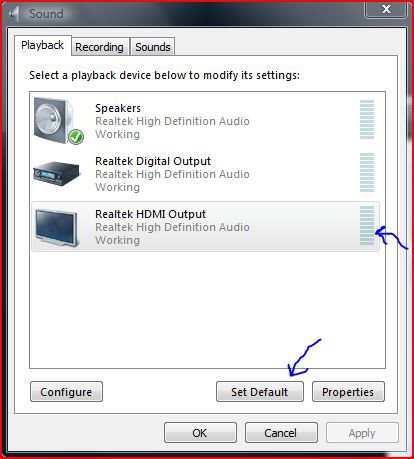

#10
I still can't fathom why I can get the windows welcome sound but nothing else. Is there a way I can just get sound without having to attach the cable?
have you set HDMi as the default sound device?
and just for future reference, yes you need the cable connected otherwise you get no sound over HDMi as stormy13 has said before.

I don't have (Realtek HDMI Output) showing in the playback screen, just the other two. With regards to my last post, I don't really mind if I have HDMI sound or not, any sound will do. That's what I meant about the windows welcome tune and then nothing. I am really nervous about connecting the lead for HDMI (when I get received it), the manual is not very clear, but I will cross that bridge when I come to it. I think this issue will be resolved in the end as you are all so helpful. I am so pleased I joined this Forum. Thanks

Let's try and clear up a couple of questions,
1. When you go to the Sound settings like in the screen shot MrNeeds posted, what is showing and what is set as default?
2. What if any speakers are connected to the computer?
3. Where exactly are the speakers connected? Are the connected to the analogue ports or the digital ports?

The reason you don't have sound over HDMI at the moment all comes back to what MrNeeds and I have been telling you, without the SPDIF cable from the onboard sound (connector is located between the back edge of the motherboard and the middle PCI slot, according to the manual for your board) to the video card (can't point that out as you didn't list the manufacturer of your video card; Asus, BFG, EVGA, etc). Borrowed this from the manual for the Gigabyte 9800 GT,
which shows the location of the SPDIF header on that card.
