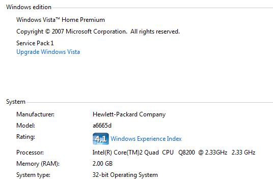

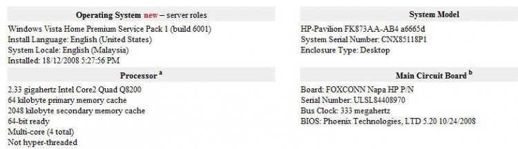

Capt.Jack Sparrow
The Black Pearl
Hi there,
Looked at the latest dump file seems like you BiosReleaseDate = 10/24/2008 is outdated, 0xC0000001 usually is a BIOS issue.

Hi, I followed some guides to update my BIOS. My computer model is hp a6665d.
So i went to this website to download a BIOS update, and I cant seem to find the right one? Can anyone link me to the right file to download to update my BIOS?
Thanks.
Software & Driver Downloads HP Pavilion a6665d Desktop PC - HP Customer Care (United States - English)
I can only find
» Napa-GL8E Motherboard BIOS Update2010-03-17 , Version:5.27, 2.01MNapa-GL8E Motherboard BIOS update resolves blue screen issues with error codes of 0x7A and 0xF4 after upgrading to Windows 7 operating system.
But i dont need this one because its for windows 7 upgrades?

Thanks, on the website it says:
You must have a Napa-GL8E motherboard.
So i used belarc (a software) to find my motherboard. Is FOXCONN Napa HP P/N a napa-GL8E motherboard?
Thanks
