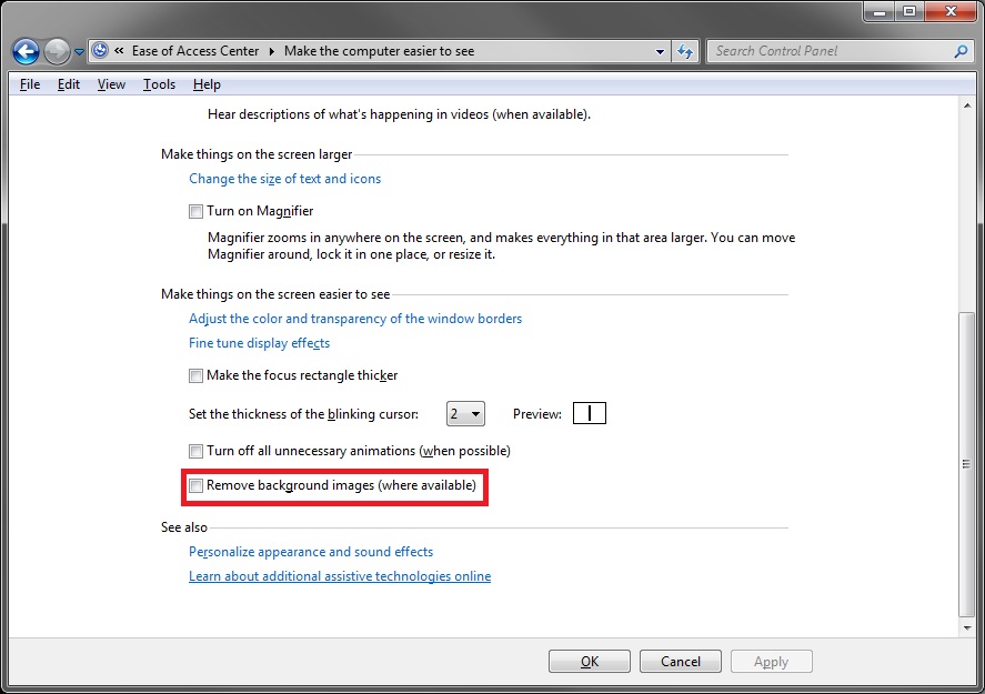

If you have a blank or solid background, then check this setting to make sure it is unchecked:
  • Open the Control Panel (classic view).
  • Click on the Ease of Access Center icon.
  • Click on the Make the computer easier to see link.
  • Uncheck Remove background images (where available) box.
  • Click on Save.

Is your Vista activated?
If it is, then also check in Make the computer easier to see in the Ease of Access Center in the Control Panel (Classic View). Make sure that the Remove background images option is unchecked.

OMG! I totally 4Got I did that! I was seriously about to completely restore my Laptop lol Thank You. But sence i did a system recovery, I no longer have the option to set the wallpaper from control panel. It says once again "Disabled, please contact system administrator" So I went aheah an ran the "Enable changing wallpaper", restarted it twice, but still no change. Please Help
Djtzan,
I have updated the "Enable_Changing_Wallpaper.reg" download in the tutorial to include another location. Please try it to see if it may work for you better now.
