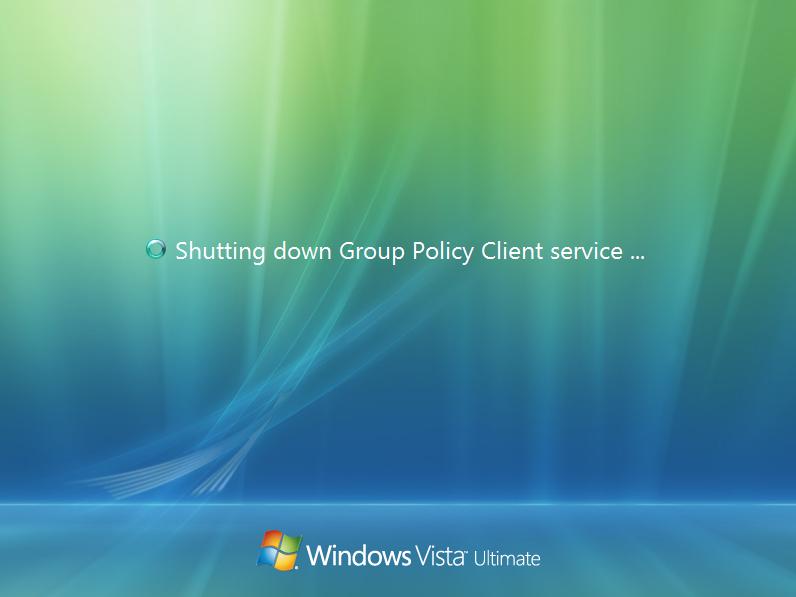

If enabled, you will get more detailed (verbose) status messages than just the normal "Logging On", "Logging Off", or "Shutting Down" messages.
EXAMPLE: Shutdown with one Detailed Status Message step

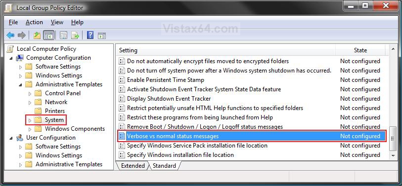

1. Open the Local Group Policy Editor.
2. In the left pane, click on Computer Configuration, Administrative Templates, and System (See screenshot below)

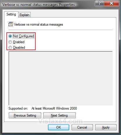

3. In the right pane, right click on Verbose vs normal status messages and click on Properties. (See screenshot above)
4. To Enable Detailed Status Messages

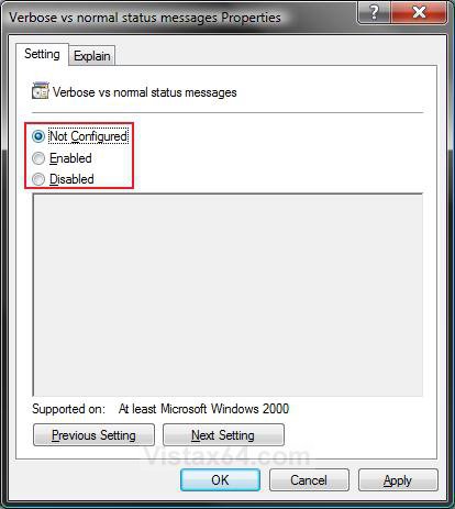

A) Select (dot) Disabled or Not Configured and click on OK. (See screenshot below step 5A)
B) Go to step 6.
5. To Disable Detailed Status Messages
A) Select (dot) Enabled and click on OK.
6. Close the Local Group Policy Editor window. Your done.

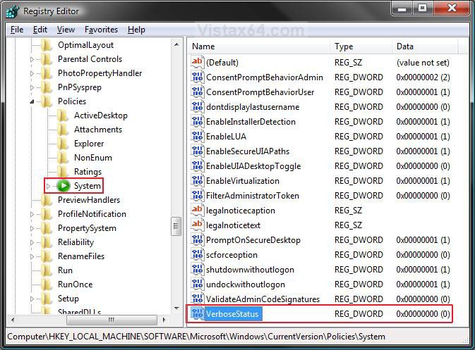

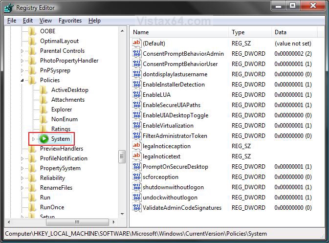

4. In regedit, go to: (See screenshot below)
HKEY_LOCAL_MACHINE\SOFTWARE\Microsoft\Windows\CurrentVersion\Policies\System
A) In the right pane, right click on a empty area and click on New and DWORD (32-bit) Value. (See screenshot below)
B) Type VerboseStatus and press Enter.

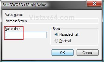

C) Right click on VerboseStatus and click on Modify.
D) Type 1 and click on OK. (See screenshot below)
E) The registry will now look like this. (See screenshot below)

6. To Enable Detailed Status Messages
A) In the right pane, right click on VerboseStatus and click on Delete. (See screenshot above)
B) Click on Yes to confirm deletion.
