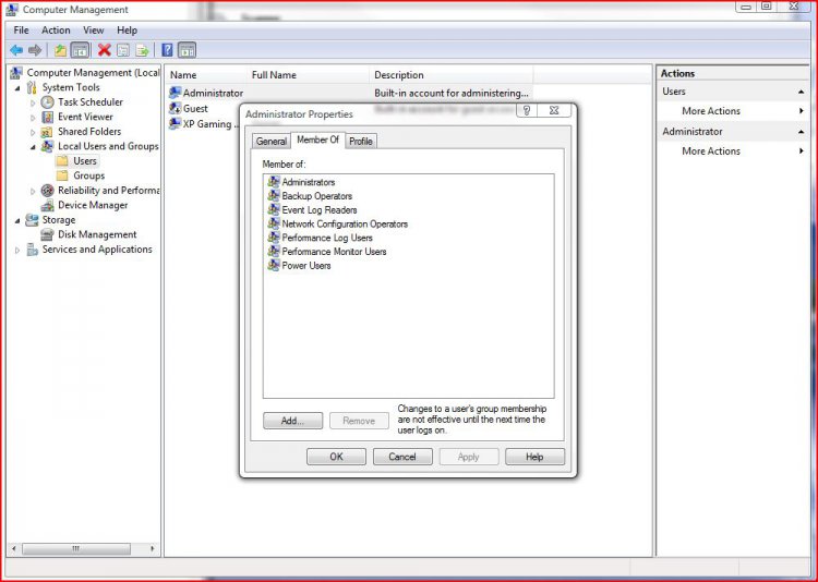

Also, just now gave these member groups to the administrator account. Not recommended?

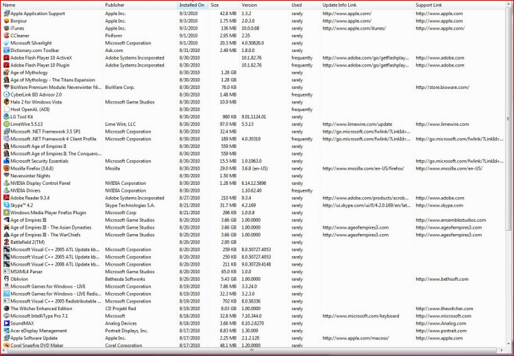

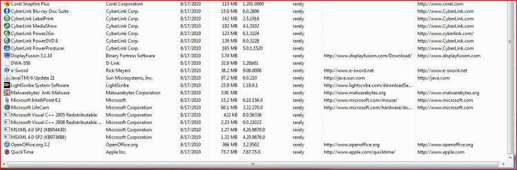

I have a sidebar app that connects to xm online radio, used to work but now connects, gets the information, displays song title and everything but doesn't play music. I have a similar thing on firefox toolbar and that one is able to play, I am able to connect to the internet. I am able to play other sounds within the system and itunes. Bonjour, like xm radio, cannot connect and has issues. I think these all suffer from the same source but I cannot find it to fix it.
Here is a list of installed programs. Understandably many are useless and I need to take the time to uninstall them.

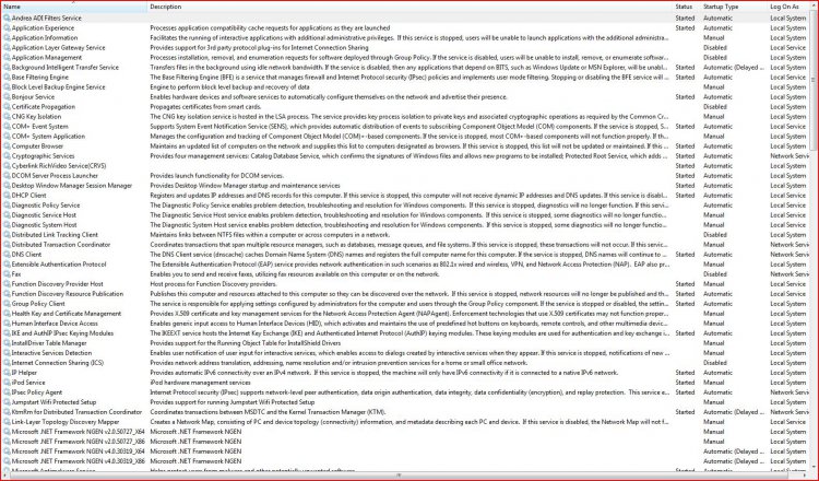

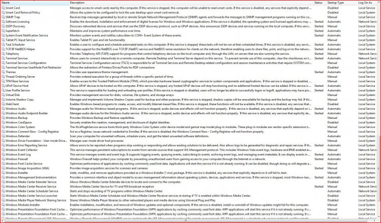

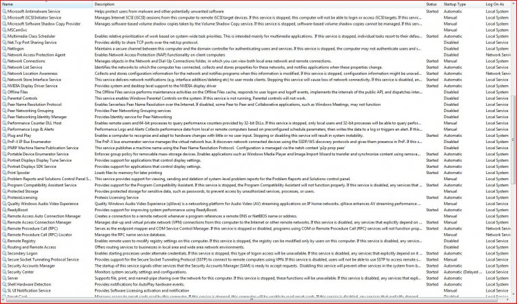

Here are my settings for my services if it helps?

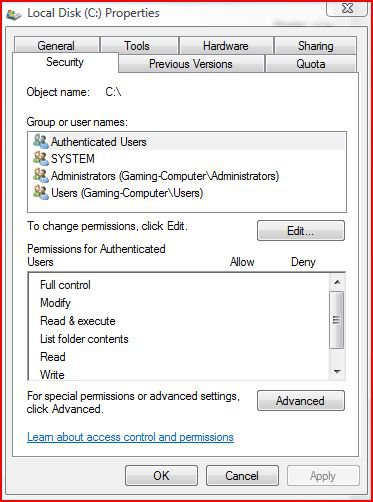

go to the security properties of your C: drive and make sure that USERS
and CREATOR OWNER are included in the group.

This is my security settings currently for C:, does it need creator owner listed under group or user names if administrator (should) has all permissions?

So after editing the services (registry is now correct), I still get the original error and Diagnostic Policy Service still wont start :(
I am now getting this error in event viewer as well: (I'll post some others too but don't think they are related)
