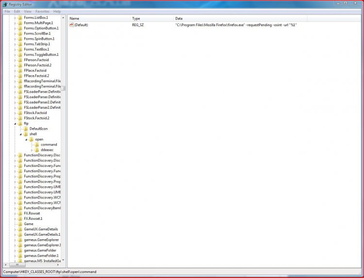

Can you please start up regedit, and navigate to: HKEY_CLASSES_ROOT\ftp\shell\open\command and tell me what your default value is in your command folder.
Here is a picture of mine so you know exactly what I mean (I use Firefox rather than IE or Windows Explorer so don't copy my value!):

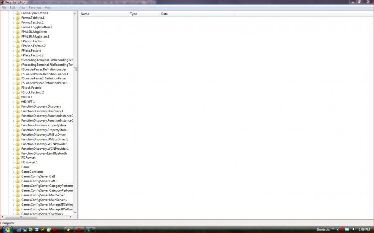

Yes....extremely difficult! For some reason, I don't have ftp under HKEY_CLASSES_ROOT (see my attached screenshot)
I actually don't use IE either (I'm an Opera man), so no worries about changing the values!
