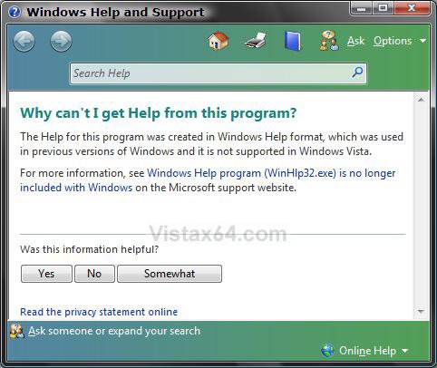

OPTION ONE
To Fix This "Help" Error Message
For more information, see: Windows Help and Support: KB917607 Article
  • The Windows Help (WinHlp32.exe) program is no longer included in Windows
2. Click Continue at the site above to download and install the patch.​
NOTE: If you get the error 80070422, the macro error code 1037, or the patch above will not install or work, then see: MS KB917607 WinHelp32 Patch

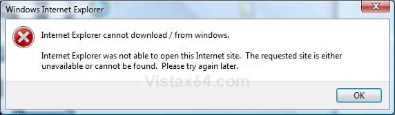

To Fix These "Help" Error Messages
These are usually caused when the Content Type registry settings for the file types: .XML, .XSL, .PNG, .JPG, .CSS is incorrect or missing.
  • Red X mark appears where the images are to be displayed.
  • CSS styles are not applied to the pages in Help and Support.
  • Error: Internet Explorer cannot download / from Windows

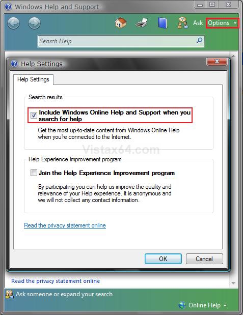

STEP ONE:
NOTE: To make sure that you have Online Help and Support enabled.
1. Click on Options at the top right corner of the Help window, and click on Settings. (See screenshot below step 3)​
2. Check the Include Windows Online Help and Support when you search for help box.​
3. Click on OK.​

Dear Shawn;
Regarding this error message: "The Windows Help (WinHlp32.exe) program is no longer included in Windows" I cheked out Windows Help and Support: KB917607 Article and downloaded the x86 patch for my 32bit windows but I'm affraid to install it on my computer because in the article there was a list of known issues which I may encounter, such as:
  • Macros are disabled
  • Cannot access .hlp files that are stored on intranet sites
  • Noninteractive user access has been blocked
  • Drag-and-drop functionality has been disabled
  • Dependencies on “How to Use Help” files
What is your opinion? Is it safe to install this patch?
Thanks: Borna
Hi Borna mir,
Yes, it is safe to install the patch. If you have any of the listed problems, then the KB917607 article shows you how to resolve them towards the bottom of it.
