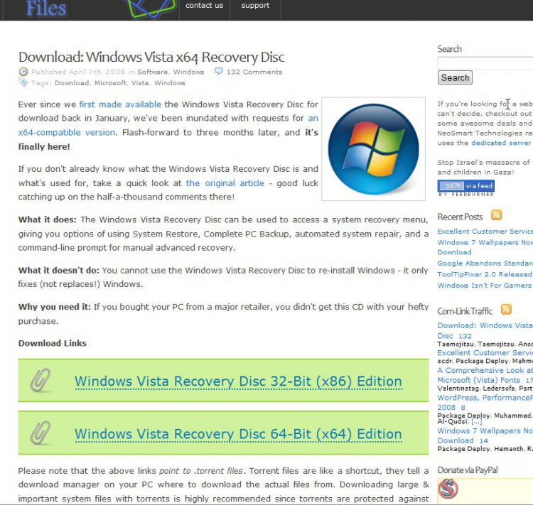

mmm thx siw2 i'll try this, but just a note while im dlin wat will this actually do, cuz i dont noe much bout computers so ye just fill me in wit a brief outline pls :)will it just repair it and boot it bak to its orginal state, or will it repair and system restore it to its factory state?
You need to download the 32 bit one. It's on the same page. It is a torrent download, so you need a torrent client - it's all explained at the link.
I have the iso on my pc , but it's too large at 120mb to post on this page for you to download direct, I'm afraid.
It is definitely worth getting as it should correct those boot problems and will be useful to you in the future as well.
Hope it helps

umm ye its just repairing atm, just wanna noe once it finishes and i boot up my comp, because i wanna restore my computer to its factory settings, but because last time this screwd up and gave me a error which resulted in the bootmger missing black screen, i was wonderin is there another way to system restore my computer ><
The startup repair should allow you to boot up. You cannot use that cd to reinstall the operating system.
If your system allows you to run off it's own "recovery" cd's , do that when you have got back into Vista.
