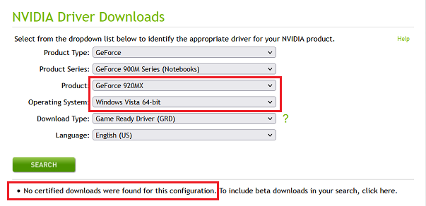

You did not tell us the make and model of your new computer and most of the hardware components (e.g., your network and WiFi cards) but I agree with townsbg that it's unlikely that you'll be able to find Vista-compatible drivers . For example, I can only see drivers for 64-bit Win 10 on the Intel HD Graphics 620 driver download page at Downloads for Intel® HD Graphics 620.
If I go to the NVIDIA site at Download Drivers | NVIDIA and search for drivers for the GeForce 920MX it tells me "No certified driver were found for this configuration" for both 32-bit or 64-bit Vista. It looks like that graphics card only has drivers for Win 7 and higher.

Your integrated graphics was characteristic of Intel processors with Kaby Lake microarchitecture. I believe you have asked elsewhere about the extended kernel, which requires 64-bit Vista, which in turn requires Ivy Bridge or earlier Intel hardware. If you want to run software that does not support Vista on that laptop, I’m sure that it shipped with an OS that is capable of doing so. But if you want to tinker with Vista, then you need older Intel hardware (or AMD) and not an Optimus laptop.
