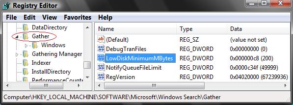

1. Open the Start Menu.​
HKEY_LOCAL_MACHINE\Software\Microsoft\Windows Search\Gather
5. In the right pane, double click on LowDiskMinimumMBytes to modify it, and do step 6 or 7 below for what you want to do. (See screenshot above)​

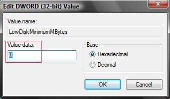

6. To Disable the Low Disk Space Warning
A) Type 0 (number), click on OK, and go to step 8 below. (See screenshot below step 7A)​

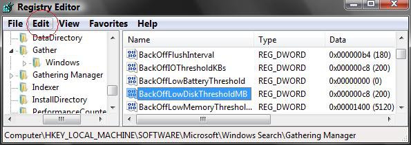

8. In regedit, go to: (See screenshot below step 10)​
HKEY_LOCAL_MACHINE\Software\Microsoft\Windows Search\Gathering Manager
9. In the left pane, click on Gathering Manager to highlight in blue.​
10. You will need to take ownership of Gathering Manager and "Allow" your user account "Full control" of it before continuing.​

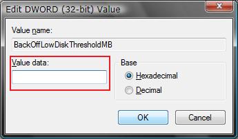

11. In the right pane of Gathering Manager, double click on BackOffLowDiskThresholdMB to modify it, and do step 12 or 13 below for what you want to do.. (See screenshot above)​
12. To Disable the Low Disk Space Warning
A) Make it empty, and click on OK. (See screenshot below step 13A)​

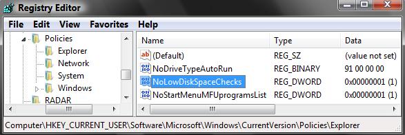

B) In regedit, go to: (See screenshot below)​

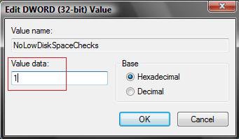

NOTE: If the Explorer key is not there, then right click on the Policies key in the left pane, click on New and Key, type Explorer, and press Enter.​
C) In the right pane of Explorer, double click on NoLowDiskSpaceChecks to modify it. (see screenshots below)​
NOTE: If the NoLowDiskSpaceChecks DWORD is not there, then right click on an empty space in the right pane, click on New and DWORD (32-bit) value, type NoLowDiskSpaceChecks, and press Enter.​

C) In the right pane, double click on NoLowDiskSpaceChecks to modify it.​
D) Type 0 (number) and click on OK. (See screenshot above)​

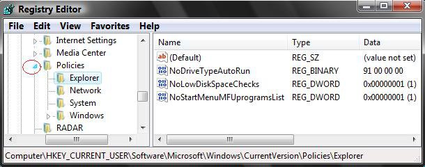

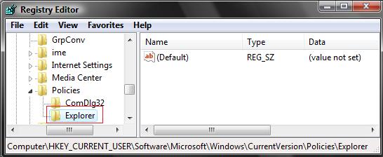

Hi Clark,

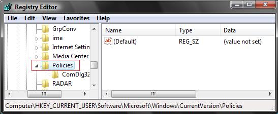

Did you click the arrow on the left side of Policies? (see circled in red below)
Otherwise, you could right click on Policies and click New > Key and then type Explorer and press enter. Then add the above to it.

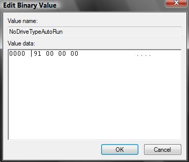

Here's the data for the Binary (see below)

Code:
Windows Registry Editor Version 5.00
[HKEY_CURRENT_USER\Software\Microsoft\Windows\CurrentVersion\Policies\Explorer]
"NoLowDiskSpaceChecks"=dword:00000001
Thanks,
Rich
