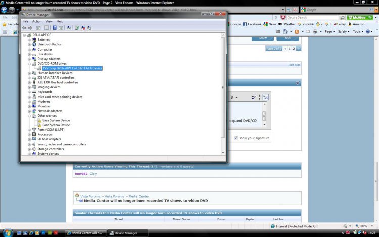

Okay good, can you do this for me:
1. Open the start menu
2. Type device manager in the search box
3. Click on device manager
At this point, you will be shown a long list of expandable categories, expand DVD/CD Drives, and you should be shown something like the photo below.
Right click on it, and select Update Driver Software...
Let it check for updates and let me know how this goes.

Clay
Driver Update says my device driver is up to date. I also tried updating the firmware on the drive recently. All good stuff, but still doesn't fix the DVD burning problem.
