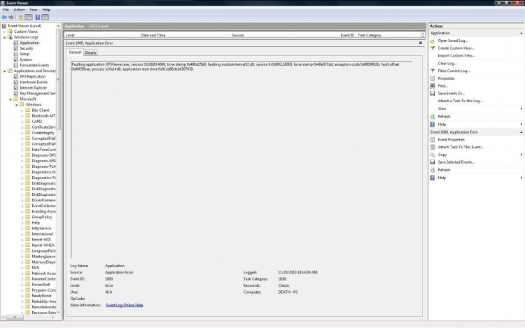

ok I was able to find this error message in event viewer, I have to step out so I have yet researched it.

Can you click on the details tab of that Event Viewer error message you posted and send a screenshot of that please?

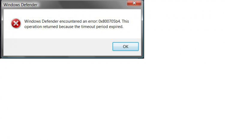

hello I fixed the problem, I formatted and deleted my hardrive. I have another issue maybe should post somewhere else but I guess I'll see what happends this error is present from a clean install.

#10
I'm sorry you felt it necessary to resort to such a drastic step to resolve the problem (I think we could eventually have solved it without needing to go so far) - but then again, it was a solution extremely likely to succeed (and apparently it did). I'm glad that issue is resolved. Though starting a new thread is commonly advised here, let's just see if we can deal with this here and do that only if we need specialized assistance.
This error typically occurs when Windows Defender is unable to update definitions. There can be several causes. Let's address the most common ones:
1. Have you activated Vista? If not, please do so before proceeding any further. If automatic activation does not work, try doing it manually. To manually activate, go to start, search box and type in slui 4 and enter. Enter your country and press next. You'll be on a screen with a phone number and a bunch of codes at the bottom. Call the number and wade through the automated prompts until you reach a human. Have your product code handy as it will be requested. Explain the situation and it's only installed on that one PC. They should give you a code to enter on that screen to activate Vista.
2. Completely update Vista with Windows Update - including SP1 and SP2 and everything else made available (except device drivers). If you can do this, one of the potential causes of the problem is eliminated. If not, we need to address the overall ability to do updates - post back in that case. You may need to do so several times between required reboots as some won't present until prior ones have been fully installed. After a clean install, this could take some time as there are over 150 updates plus the service packs (depending on where you started based on the version on the Installation Disk you used).
3. Confirm that the Defender Service is started and automatic:
a. Click Start and in Start search type services.msc and press Enter.
b. In services window, locate Windows Defender service in the services list.
c. Verify that the Status is Started and the startup type is Automatic. You may need to reboot for this change to take effect.
4. After this, update the Windows Defender definitions (which is the real cause of the message assuming the above did not resolve the problem). It may occur automatically once all the updates are installed or you may need to configure it to be done automatically or you may need to do it manually. The following articles may help: How to troubleshoot definition update issues for Windows Defender, http://support.microsoft.com/kb/836941, http://support.microsoft.com/kb/923159 .
I hope this helps. If not, post back and we'll examine some of the less common causes. Please include the names and versions of any other security software you have installed and/or are running. Also, please advise when this message occurs.

40
#11
amazing that I can wipe out all of my data and reload fresh and clean and begin with a windows defender error. I read that microsoft security essentials shuts windows defender down but so I go to my processes and shut of microsoft security essentials and windows defender still will not turn on. clicking on the link looking button to turn windows defender makes it just sit there, you cannot do anything on the window including closing it normally. also I find that I red that a registry problem may cause it and I do a registry scan and I already have 200 some odd errors and Ive done nothing but install the updates from microsoft and a few other things like flash and java and direct x and my dvd software. so I must of boughten or downloaded errors a fist of errors!!! hah! so I heard that microsoft security essentials and windows defender may not work together but why would microsoft do that~ no uninstall windows defender either. it just erks me to have something on my computer not working right. anyhow I don't know what else to do, I am researching this, any tips are helpful.
thanks happy computing I bet nobody has a computer that can't get an error from surfing on the net so much for universality.

#12
Download Autoruns Autoruns for Windows and install and run it. It is far superior to but does essentially the same thing as msconfig. Click on the Everything Tab. Now go through every entry and find ANYTHING that relates to Windows Defender (but not to MSE) and uncheck the box to prevent it from starting at startup. Save the changes and reboot. If you found something, I'll bet it was a process to update Defender which wouldn't work because Defender was disabled by MSE and that this fixes the problem and eliminates the error message.
I'm not 100% certain, but knowing that MSE disables Defender - it cannot uninstall it because Defender is built into the Vista system too deeply and cannot be uninstalled (and it disables it because it does cause a conflict because everything in Defender is in MSE so Defender is not necessary at all) and that you have installed MSE but are still getting a Defender error suggests this might work and is at least worth a try.
I hope this helps.
Good luck!
P.S. If you started and put the Defender service on automatic as previously suggested, please deactivate it again. Although this probably occurred through Autoruns, it's best to check services directly to make sure.
