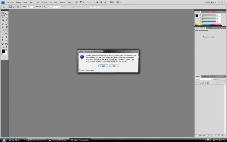

Lemur.. The attachment is what I was refering to when I said PS CS4 EXTENDED wanted me to update my video card.

There is one thing that I distinctly remember, do not let vista or any other program try to update any sort of driver and everything will be fine. Update it manually from the manufacturers site. :)

I would need more information about that, but my first reaction is - I don't want Adobe interfering with my video card. I'll do more research later...

How would I go about doing that where I could stop Photoshop telling me I should update my video drivers ? This is my first time using Photoshop never used it before . Better yet how would I have VISTA do that ?
lemur
The accelerator is different from the regular video driver. You should always be fine updating your video card driver, and I'd recommend it. If you have an NVidia card, go to their driver download - Drivers - Download NVIDIA Drivers - and select the driver appropriate for your card and operating system.

Wasn't Photoshop asking me to update my video card driver ? Cause thats what it did when I clicked on YES.

Yep.

Its probably an option. I haven't used PS in ages. But I'm sure you can turn it off somewhere in the program's options.

You can disable automatic updates in photoshop by going to “help > updates… "
