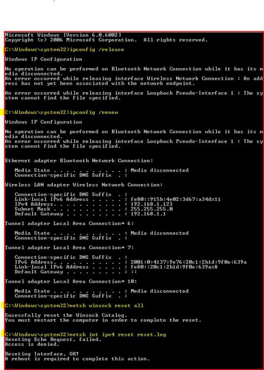

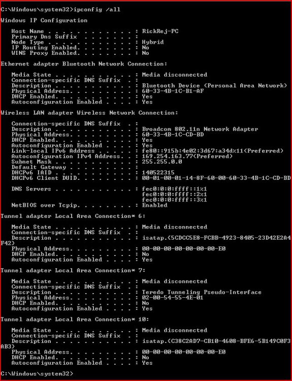

-ipconfig /all results in attached file #1
-ipconfig /renew + /release (error, see attached file #2)
-netsh winsock reset (worked fine actually, see #2)
-netsh int ipv4 reset reset.log (error, see attached file #2)
-netsh int ipv6 reset reset.log (error, see attached file #2)

After you did all that, what happened? It looks as though the reset did the trick!

I have like three computers all connected to the same network, though, so it might be an IP conflict, I'm not sure. Could this be the problem?
