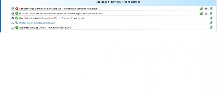

This is what driver detective found with regards to my sound card, I'm not sure if it will fix the problem so I didn't register yet cause I think all the software would do is to reinstall the driver which I already did without any success. Any opinions on this ?

Using the software didn't fix my sound issue, although as shown previously in a snap shot it did detect an unplugged device "conexant high definition smartaudio 221 device" the software reinstalled the driver but at a certain point an error poped up saying device counld not be detected.
