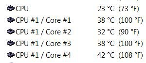

I have the same chip - and some cores simply stop responding at idle temps.
From day one my Core #4 was stuck at 42c, my Core #3 38c and over time my Core # 1 eventually stuck at 38c. The only core that still has movement is my core #2
However, since they all move when under load, and the the CPU (Tcase) temp is accurate, it's not a problem.
I've been overclocking this chip of mine for exactly a year now, so the 'stuck' sensors aren't a cause for concern or a sign of impending failure :)
