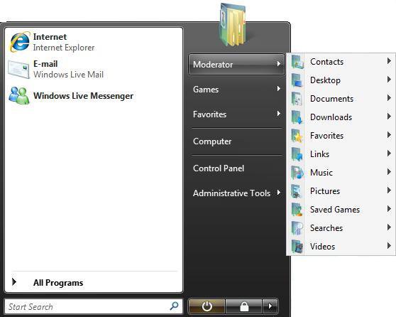

EXAMPLE: Personal User Profile Folders
EXAMPLE: Personal User Profile Folders Start menu Location

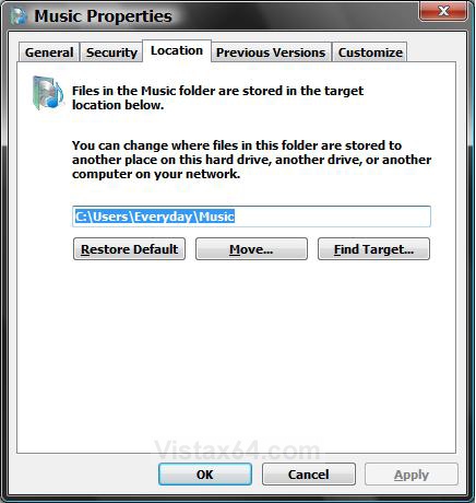

1. Right click on the user folder that you want to restore the default location for and click on Properties.​
NOTE: Do this from the C:\Users\(user name) location for the best results and not from the Start menu user folders.​
2. Click on the Location tab. (See screenshot below step 3)​
NOTE: If you do not have a Location tab, then this is not the correct user folder and is only a normal folder that has the same name as the user folder. You will most likely need to use OPTION TWO below in this case instead.​

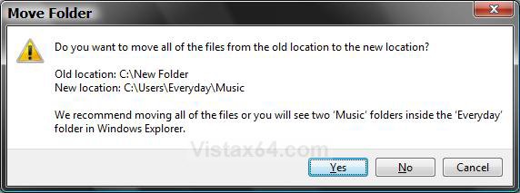

3. Click on the Restore Default button and click on OK. (See screenshot below)​
4. If you get this, then click on Yes. (See screenshot below)​
5. Click on Yes. (See screenshot below)​
WARNING: If you do not click on Yes, you will have two copies of the personal user folder in the main (user name) folder with one being as described in the NOTE under step 2.​

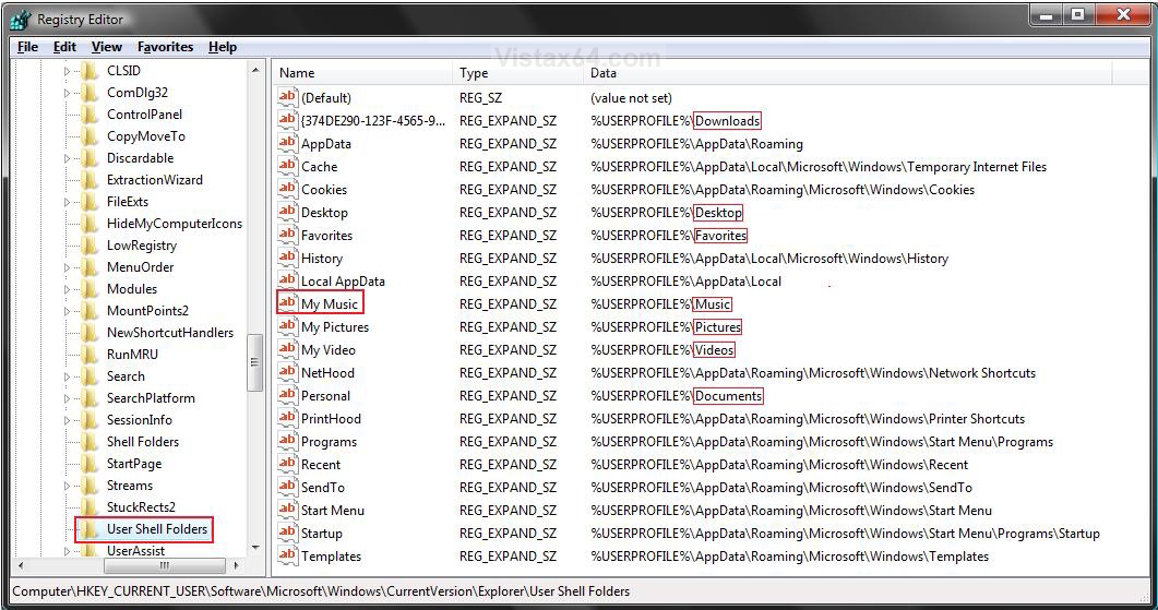

Manually Restore User Folders with Reg File Download & Registry Editor
This is a more thorough method of restoring a user folder's default location, or restore missing user folders.
The reg files in the downloads below will restore the default values at this registry location below.
Code:
HKEY_CURRENT_USER\Software\Microsoft\Windows\CurrentVersion\Explorer\User Shell Folders

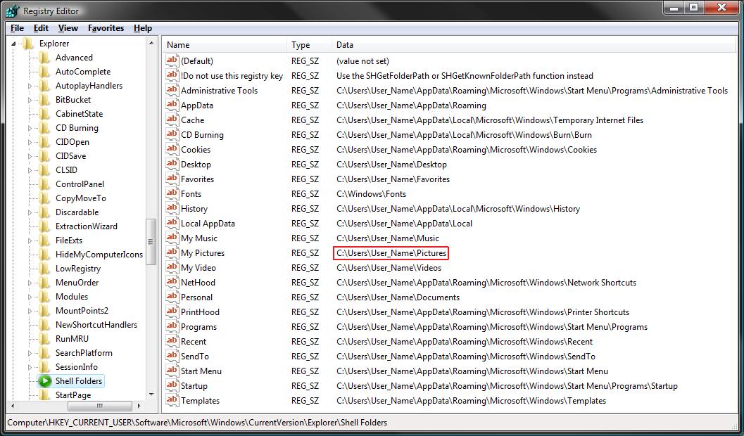

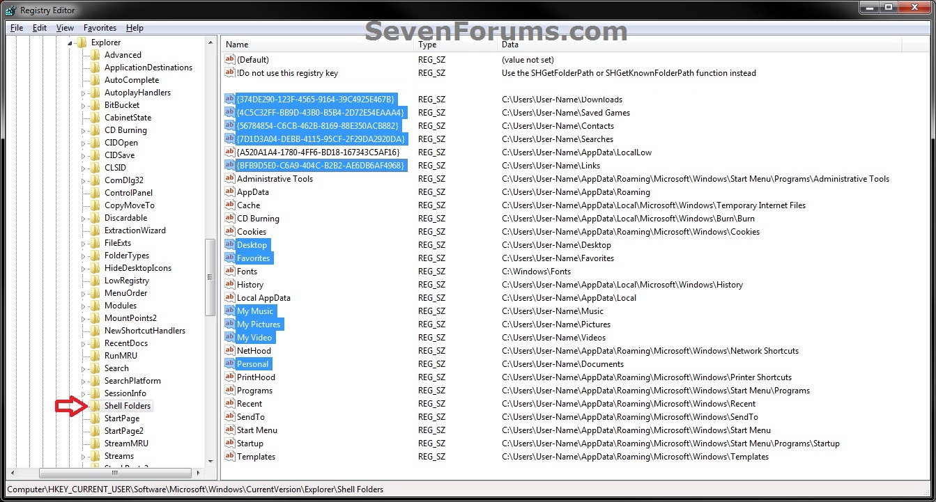

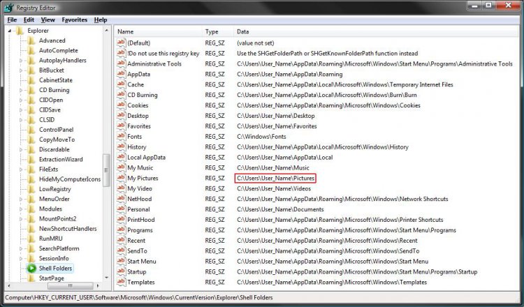

18. In regedit, navigate to the location below. (see screenshot below)​
Code:
HKEY_CURRENT_USER\Software\Microsoft\Windows\CurrentVersion\Explorer\Shell Folders

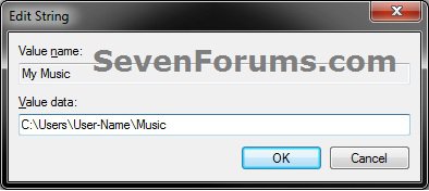

19. In the right pane of Shell Folders, right click on the user folder in the Name column in the registry (see table below) that you want to restore, then click on Modify. (see screenshot above)​
NOTE: If the Name entry in the table below is not there, then right click on a empty space in the right pane, click on New and String Value, and give it the name in bold below for that user folder.​

20. Type in the full default path (see table below) of the user folder, and click on OK. (see screenshot below)​
NOTE: Substitute User-Name in the full path with your user account name instead.​

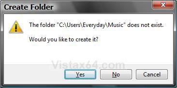

25. Open the Start Menu, then Copy and Paste the Shell command (see table below) in the search box for the User folder that you want to restore, and press Enter.​
NOTE: If this opens the missing personal user folder(s), then you are done and can skip step 26 and go to step 27 instead.​

I moved, and I think probably deleted, the Music, Pictures, Videos and Downloads folders.
I tried method 1, but when I type in any of the shell commands (e.g. shell:Music) nothing is found. I then tried method 2, but when I looked at the Registry information, all the information in the data column is exactly as it should be (e.g. for the pictures folder %USERPROFILE%\Pictures).
Can anyone help?
Thanks
In the registy window I replaced all the data for the files in question with the exact same data that was there, not really thinking it would change anything, then restarted the computer 4 or 5 times. Now the Music and Video folders are back, and are in there default locations! The downloads and Pictures folders are still nowhere to be found, not even using the shell:Pictures and shell:downloads mentioned in method one :S
Hi Mojopin85, and welcome to Vista Forums.
To verify, make sure that you are using the following for them.
Music:
%USERPROFILE%\Music
shell:My Music
Downloads:
%USERPROFILE%\Downloads
shell:downloads
It should change this location in the registry for you as well, sometimes after a restart, but check to verify it has the correct location for Pictures as well.
attachment.php

Hello, my music folder and pictures folder are both yellow folders. I did the steps above but they both have the default location. In step 4 (insert below) it says if it does, go to step... but then it doesn't give a next step.
4. In the right pane, check to see if the missing personal user folder (under Name column) has the default %USERPROFILE% location (under Data column) for it.
NOTE: You can see all of the default locations in the screenshot below. If it does not have the default location, then proceed to step 5 to change it. If it is, then go to step .
Music:
%USERPROFILE%\Music
shell:My Music
Downloads:
shell:downloads
attachment.php
