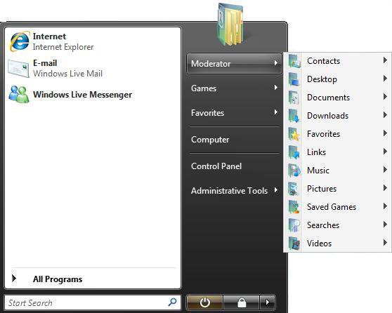

EXAMPLE: Personal User Profile Folders
EXAMPLE: Personal User Profile Folders Start menu Location

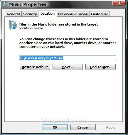

1. Right click on the user folder that you want to restore the default location for and click on Properties.​
NOTE: Do this from the C:\Users\(user name) location for the best results and not from the Start menu user folders.​
2. Click on the Location tab. (See screenshot below step 3)​
NOTE: If you do not have a Location tab, then this is not the correct user folder and is only a normal folder that has the same name as the user folder. You will most likely need to use OPTION TWO below in this case instead.​
3. Click on the Restore Default button and click on OK. (See screenshot below)​

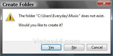

4. If you get this, then click on Yes. (See screenshot below)​

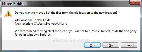

5. Click on Yes. (See screenshot below)​
WARNING: If you do not click on Yes, you will have two copies of the personal user folder in the main (user name) folder with one being as described in the NOTE under step 2.​

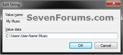

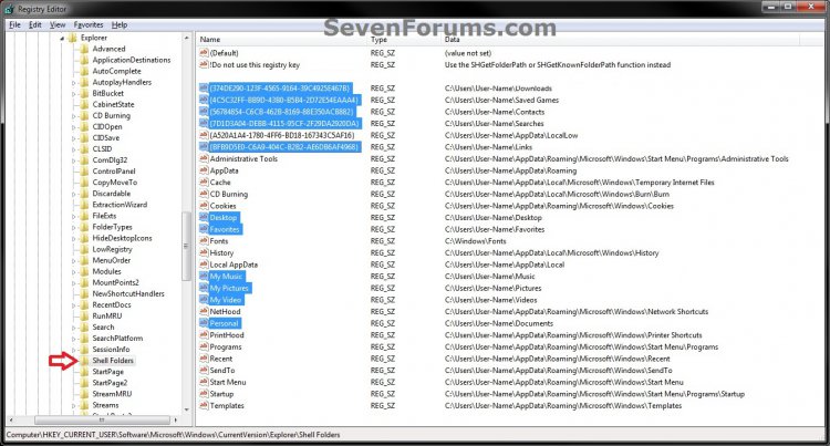

18. In regedit, navigate to the location below. (see screenshot below)​
Code:
HKEY_CURRENT_USER\Software\Microsoft\Windows\CurrentVersion\Explorer\Shell Folders
19. In the right pane of Shell Folders, right click on the user folder in the Name column in the registry (see table below) that you want to restore, then click on Modify. (see screenshot above)​
NOTE: If the Name entry in the table below is not there, then right click on a empty space in the right pane, click on New and String Value, and give it the name in bold below for that user folder.​

20. Type in the full default path (see table below) of the user folder, and click on OK. (see screenshot below)​
NOTE: Substitute User-Name in the full path with your user account name instead.​

25. Open the Start Menu, then Copy and Paste the Shell command (see table below) in the search box for the User folder that you want to restore, and press Enter.​
NOTE: If this opens the missing personal user folder(s), then you are done and can skip step 26 and go to step 27 instead.​

Hello Kyle, and welcome to Vista Forums.
To be safe temporarily copy anything you have in those folders somewhere other than in a user folder as a backup.
Now, delete the folders that are not correct, and restore the default locations for them using either option in Method Two. You may need to restart a couple of times afterwards to have everything restore back to normal.

I used method three and used the provided reg file, then manually verified with regedit. I've also done a dozen reboots.
