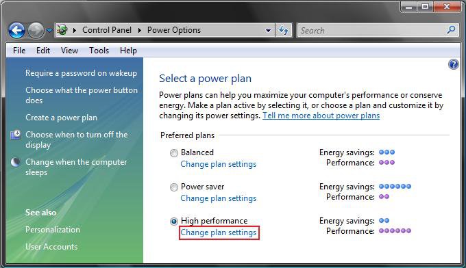

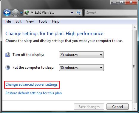

NOTE: Power settings control the computer’s ability to go into and come out of sleep/standby mode.
1. Open the Control Panel. (Classic View)
2. Click on the Power Options icon.
3. Click on the Change plan settings link under your power plan. (See screenshot below)

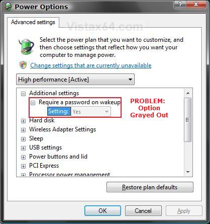

4. Click on Change advanced power settings. (See screenshot below)
5. Click on Change settings that are currently unavailable. (See screenshots below step 10)
NOTE: This will allow any Power Options that are grayed out to now work and not be grayed out.

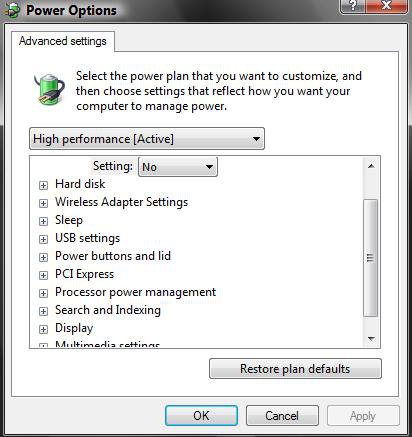

6. Recommended Settings for Sleep
NOTE: Sleep saves any open documents and programs to memory only, and then puts the computer into a low-power state.
WARNING: If you lose power to the computer, you will also lose what is in memory.
Main Setting | Sub Setting | Recommendation |
Hard disk | Set to at least 1 minute before the computer (Sleep after setting below) is set to sleep. | |
Sleep | Sleep after | This is for the computer. Set to at least 1 minute after Hard disk and Display is set to turn off. |
Sleep | Allow hybrid sleep | Set to Off. |
Sleep | Hibernate after | Set to Never. |
USB settings | USB selective suspend setting | Set to Disabled. |
Power buttons and lid | Start menu power button | Set to Sleep. |
PCI Express | Link State Power Management | Set to Off. |
Display | Turn off display after | Set to at least 1 minute before the computer (Sleep after setting above) is set to sleep. Usually set this as the same as the Hard drive is set to turn off. |
Multimedia settings | When sharing media | Set to Allow the computer to sleep. |

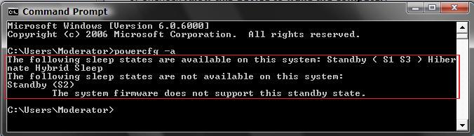

1. Open the Start Menu.
2. In white line (Start Search) area, type cmd and press Enter.

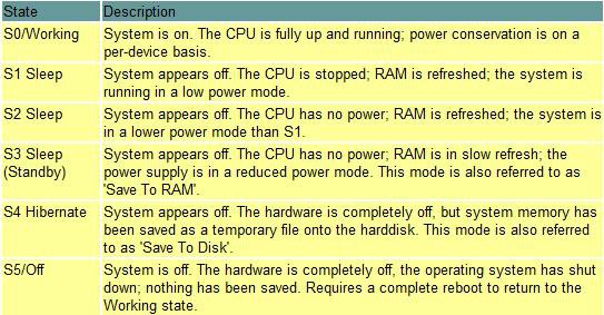

3. In command prompt, type powercfg -a and press Enter. (See screenshot below)
NOTE: This will give you a report of the available sleep states for your computer and will attempt to report reasons why sleep states are unavailable. You will want to see if the ACPI S1 and/or S3 is listed.
4. Restart the computer into the BIOS settings, and go into the Power Management section in the BIOS.
NOTE: Usually you will press the F2 or Delete key as soon as your computer starts booting to enter the BIOS.
5. Make sure ACPI mode: S3 or S1 is enabled.
WARNING: S1 (Sleep) and S3 (Hybrid deeper sleep). If you are running an incompatible video card, some or all of these states below may be unavailable. If one of the settings causes your computer to not wake back up afterwards, then reset the CMOS on the motherboard and restart the computer, or unplug the computer for a moment and plug it back in, and reset the BIOS back to the factory default settings.

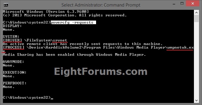

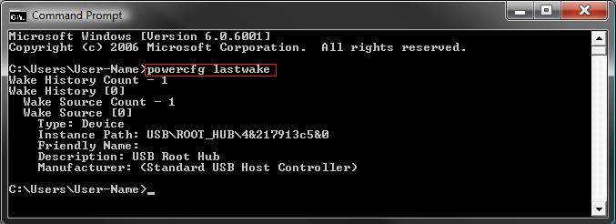

NOTE: This will give you a list of items that woke up the computer last that may help narrow down what is waking up the computer.
3. In command prompt, type powercfg lastwake and press Enter. (See screenshot below)
NOTE: Notice that I had USB\ROOT\HUB listed. For me, this would be the USB wireless mouse. Your list results will vary of course.

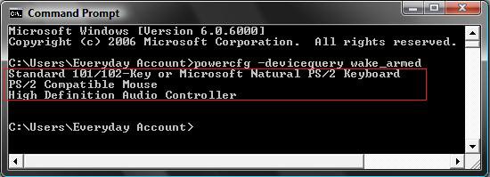

1. Open an elevated command prompt.
2. To List Devices that Can Wake Up the Computer
A) In the command prompt, copy and paste in bold: (See screenshot below)
powercfg -devicequery wake_armed and press Enter.
B) Go through the list of devices to see if you have one you do not want to wake up your system.
EX: A Network Device (Modem, Ethernet, etc.) or Wireless Mouse.
C) If you found a device that may be causing the problem, then check with the STEP SIX section below first to see if you can disable a wake up option for the device in it's Power Management settings in Device Manager to test to see if that is it before proceding.

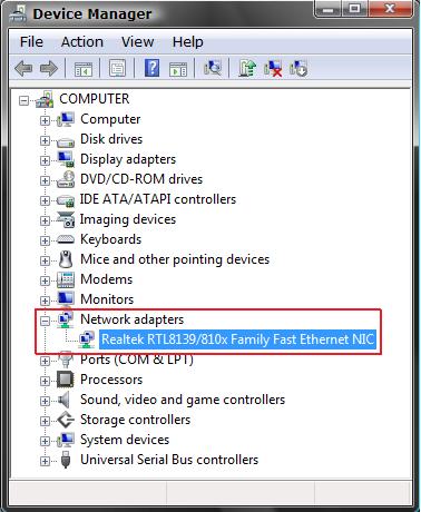

2. Click on the Device Manager icon.
NOTE: You need to be in a Administrator account.
3. Click on Continue in the UAC prompt.
4. Open the device's list that you want to change. (See screenshot below)
EX: Network Devices

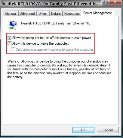

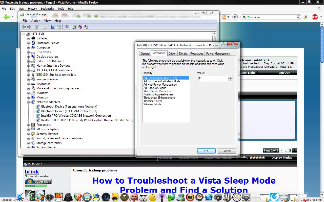

5. Right click on the device name and click on Properties.
EX: Network Devices
6. Click on the Power Management tab. (See screenshot below)
7. Uncheck Allow this device to wake the computer. (See screenshot above)
NOTE: To Enable it again, just check this instead. If you need to disable the wireless mouse and keyboard, then you can wake the computer by pressing the power button on the case.
8. If listed, check Allow the computer to turn off this device to save power. (See screenshot below step 6)
NOTE: This will turn the device off when the computer goes into sleep mode.

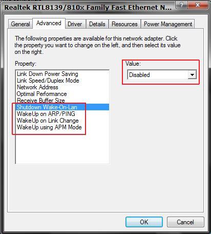

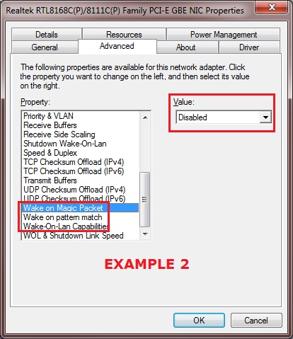

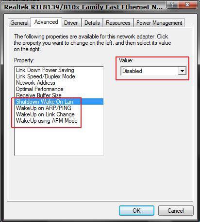

9. Click on the Advanced tab. (See screenshot below)
NOTE: This is only for the Network device.
10. Check the boxed in red Property: items below to see if they are set to Disabled in the Value: area. (See screenshot above)
NOTE: This area may be different for your particular network device since it is based on the driver, but it should be similar. You will be looking for any Wake on type property options listed.
11. Click on OK to apply and close properties window. (See screenshot below step 6 or 9)

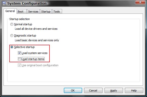

A) In the white line (Start Search) area, type msconfig and press Enter.
B) Go to step 3.
OR
2. Click on All Programs, Administrative Tools, and System Configuration.
4. Under the General tab, dot Selective startup. (See screenshot below)
NOTE: When done with the test, dot Normal startup, to return to the default settings before the test, and click on OK.
5. Uncheck Load startup items and click on OK and restart the computer.
NOTE: You will get a notification that you made changes to the Startup programs in the bottom right Notification area. Just ignore it for now. It will go away when you put it back to Normal startup after you finish.
6. Test sleep mode.
7. If unchecking (disabling) Load startup items fixed the sleep problem, then enable one startup item at a time and test to see if the problem occurs again. Continue enabling startup items, until you find the program that is causing the problem. Remove or update the problem program.
NOTE: See Method One or Two here: How to Check and Change the Startup Programs in Vista
A) When done, change the setting back to Normal startup (step 4).
8. If unchecking (disabling) Load startup items did not resolve the sleep problem, then set it back to Normal startup (Step 4) and go to the next step below.

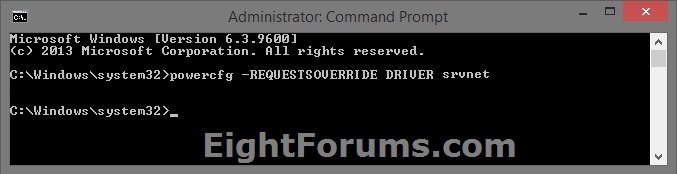

By using power availability requests, applications, services, and drivers can temporarily disable power management features to accomplish user scenarios. Availability requests can prevent the display from turning off after inactivity, and prevent the computer from automatically sleeping, enable Away Mode, and shutting down.
1. For how, see: How to View and Override Power Availability Requests in Windows
