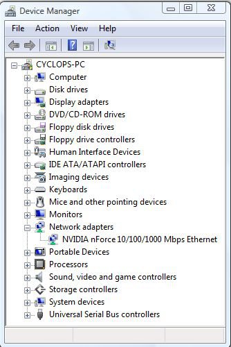

Hi asmita616 and welcome to the forums :party:
Have you checked 'Device Manager' to see if there are any problems with your network devices? To do this, click on the start orb and type 'Device Manager' into the search box. In the 'Programs' area of the results list, right click on this program and select 'Run as administrator'. After providing administrative credentials, the program will open. Expand the 'Network adapters' category as shown below. Does this (or any other) category have a yellow triangle with an exclamation mark in it next to it? If so, please attach an image (follow the tutorial link below if you are unsure how to do so) showing this to a reply, together with as much detail of your hardware as possible. The more information that we have, the better chance we have of being able to come up with the answer to your problem.

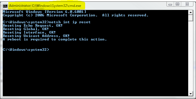

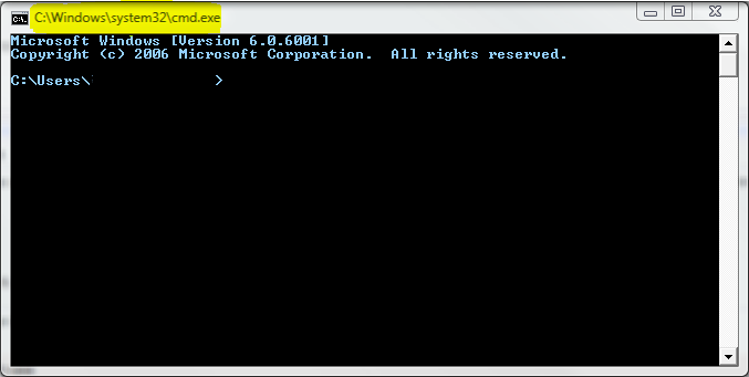

Again, you're mistaken. Just because you are logged in as an administrator doesn't mean you have full administrative privileges.
Consider it like this - although a member of the administrators group, Vista users act more like *nix - so that you are more like a wheel group user than anything, as opposed to actually *being* root - and in order to accomplish tasks you need to do things in Vista's version of sudo.
Now, the easiest way to do this is to click the Start Orb, then in the search area type CMD - when you see the CMD Prompt icon populate in the search list, right click it and select "Run as Administrator" (sudo).
Then, you can perform the steps without the errors.
I have attached 2 screen shots to show that this works just fine:
In this mode you'll get an error on three (at least) things that you need to try. Notice the highlighted title: No Administrator.
In this mode it works just fine - as I have demonstrated. Again, notice the title - this time you're running CMD with administrative privileges - aka running sudo {command}.
