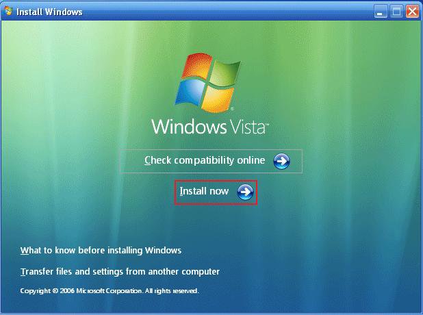

2. Click on Install Now to start the upgrade. (See screenshot below)
NOTE: If AutoPlay does not load the Vista setup screen, then open your DVD drive in Computer and click on the Setup file.

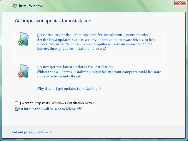

3. If you want Vista to check for updates during the installation, then click on that to select it. (See screenshot below)
NOTE: It will install faster if you select Do not get the latest updates for installation. You can install them later through Windows Update.

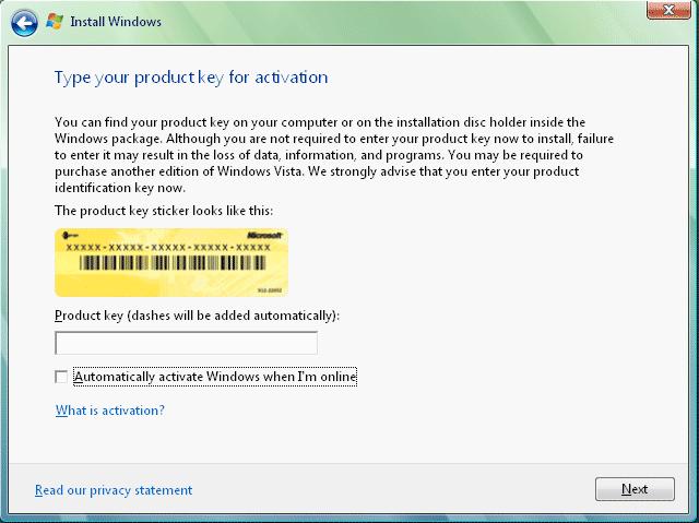

4. Do not type in a product key. (See screenshot below)
WARNING: If you do type in the same activated product key that you already have installed, then you can end up in Reduced Functionality Mode.
5. Leave the Automatically activate Windows when I'm online box unchecked.
6. Click on Next.

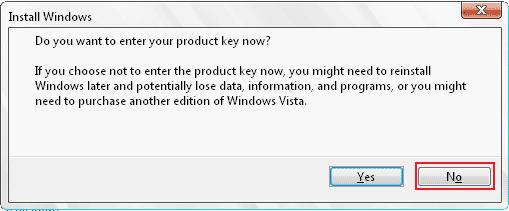

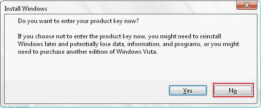

7. Click on the No button for the Do you want to enter your product key now? prompt. (See screenshot below)

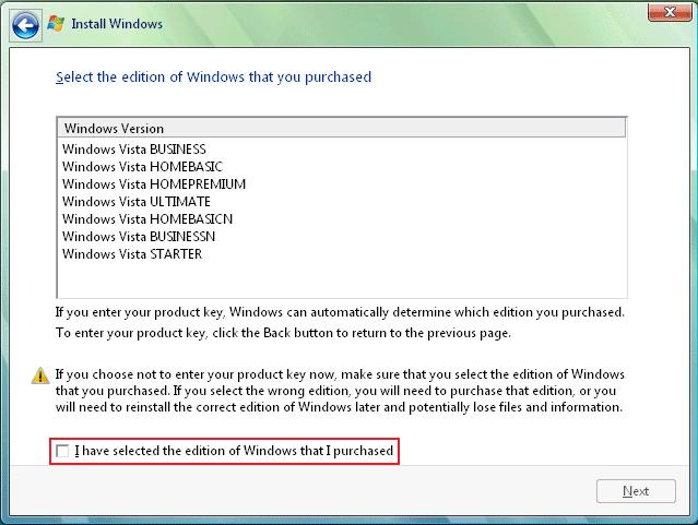

8. Select which edition of Vista you have. (See screenshot below)
9. Check the I have selected the edition of Windows that I purchased box and click on Next. (See screenshot below)

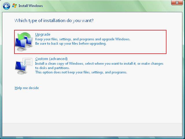

10. Click on the Upgrade option. (See screenshot below)

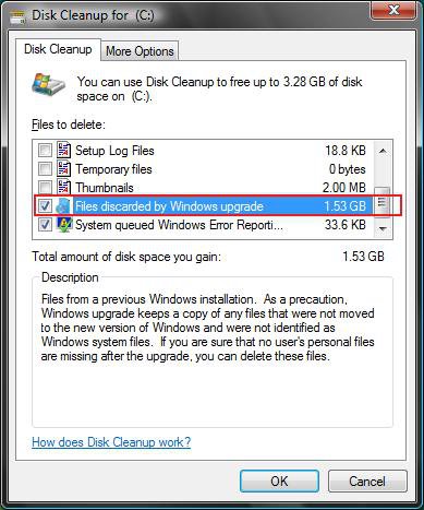

14. Run Disk Cleanup.
A) If listed, check Files discarded by Windows upgrade. (See screenshot below)​
NOTE: These will be the leftover upgrade files, C:\Windows.old, C:\$INPLACE.~TR and C:\$WINDOWS.~Q, that did not get copied over. If any personal username files are missing, it would be in these folders.​
B) Click on OK to delete it.​

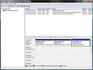

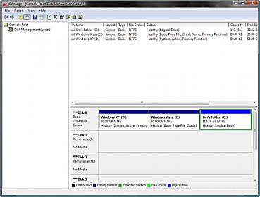

How do I know which is in the primary boot drive?
I have three partitions- my data, Vista, and XP. And XP was installed first.
    1TB Samsung 990 PRO M.2,
    4TB Samsung 990 PRO PRO M.2,
    Galaxy S23 Plus phone
Ok, so I opened up the disk manager. For Windows Vista under the Status column, it says Boot.
This means its the primary boot drive right? Even though I had XP installed first. Also, for my Windows XP volume, it says System, Active under the status column. I added a screenshot to show you what I mean.
And one last question. I'm doing this because when I run "sfc /scannow" command in the CMD window, it gives me an error saying that Windows found corrupt files but couldn't fix them. Even though nothing seems to be wrong with Vista, should I continue this Repair Install to fix that error message?
Thanks a lot for all the help with this.
Jim,
Since Vista is listed as the Boot drive, then it should be ok to run the repair install. Just be sure to select the same partition drive letter for Vista when installing. To be safe, I would backup anything you do not want to lose just in case something goes wrong.
