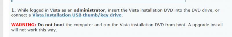

1. While logged in Vista as an administrator, insert the Vista installation DVD into the DVD drive, or connect a Vista installation USB thumb/key drive.
WARNING: Do not boot the computer and run the Vista installation DVD from boot. A upgrade install will not work this way.

I went to do this on my Vista VM and the upgrade option was greyed out with a statement that upgrade has been disable and must be performed from within Windows. Will this work to perform a repair install if launched within Windows?
That's how it works, upgrade installs (Repair Install is an upgrade install) must be done from within Windows.
Here is step 1 of this tutorial,

Ok thanks. I suppose that this unfortunately isn't an option for anyone that can't boot Vista.
Yeah, unfortunately, that group won't be able to do this.
