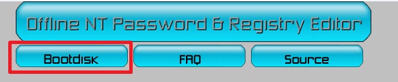

Offline NT Password and Registry Editor
1. For how, see this site: Offline NT Password and Registry Editor
NOTE: If you have no access to your computer, then you will need to create this boot CD/DVD or USB key drive on another computer so you can use it to boot into yours with and use.​
2. Click the Bootdisk button at the top of that website. (See screenshot below)​
3. Scroll down to the Download section and download the lastest version ZIP file (ex: cd######.zip) for the Bootable CD image under (CD release, see below on how to use).​
4. Extract the cd######.iso file from the downloaded ZIP file, then burn the ISO file to a DVD or USB key drive.​
NOTE: You can use any ISO burner program you like, but the free ISO Recorder or ImgBurn programs are good ones to use.
5. Follow the instructions from their website on how to use the boot CD/DVD or USB key drive. See: Offline NT Password & Registry Editor
NOTE: Please direct your questions about this tool to the site providing the tool.
