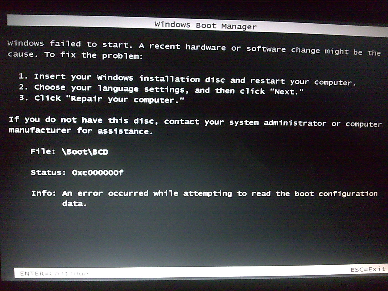

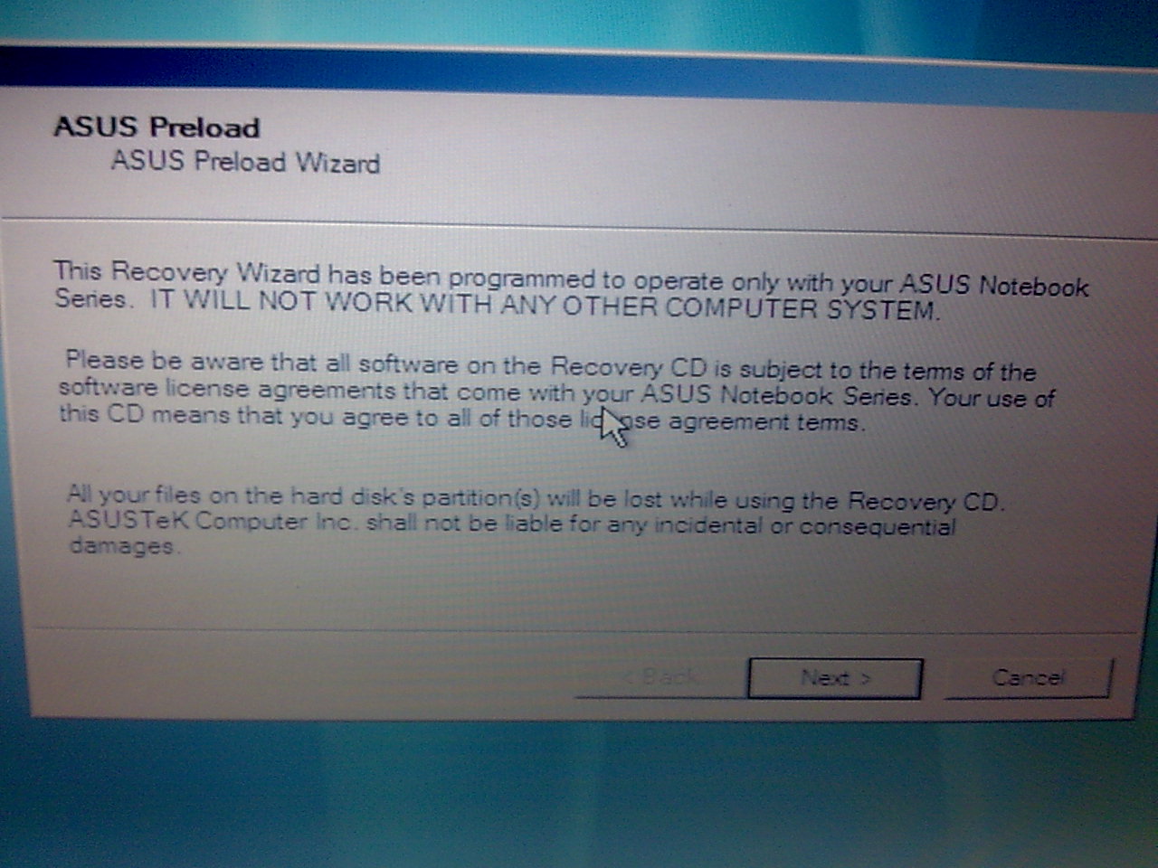

This morning i turned on my laptop (Asus M50SV) and everything was ok. i saw that there were new microsoft updates, so i checked all of the impotant files and download it. and then i restarted my laptop, then after the asus screen, Windows Boot Manager showed up and the image below was shown on the screen:
i dont want(again) to reinstall windows vista and i only have recovery dvd for my laptop. do you think this startup repair will manage my problem? what do you think is the cause of this mess? i even tried safe mode to try system restore but asus preload wizard will appear suddenly and it will use the recovery dvd to restore windows and delete my files.. hope u'll help me in this shawn..
tnx..

Hello Blackhawk,
You have a OEM recovery cd that is not capable of doing a Startup repair, only a clean install of Vista to factory defaults instead.
Howevery, this tutorial will show you how to create a Recovery Disc that you can use to do a Startup Repair with to hopefully fix your boot (BCD) file.
