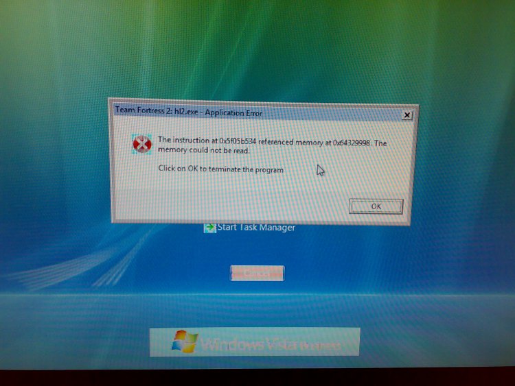

okay, i'll post some more details + screenshots, maybe it'll help
so, screenshots:
#1 - the game crashes, i hit ctrl-alt-del to go to desktop

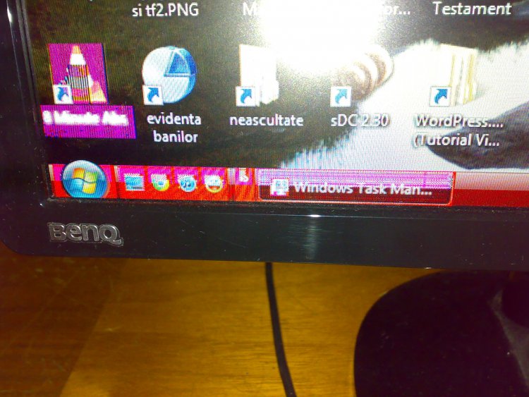

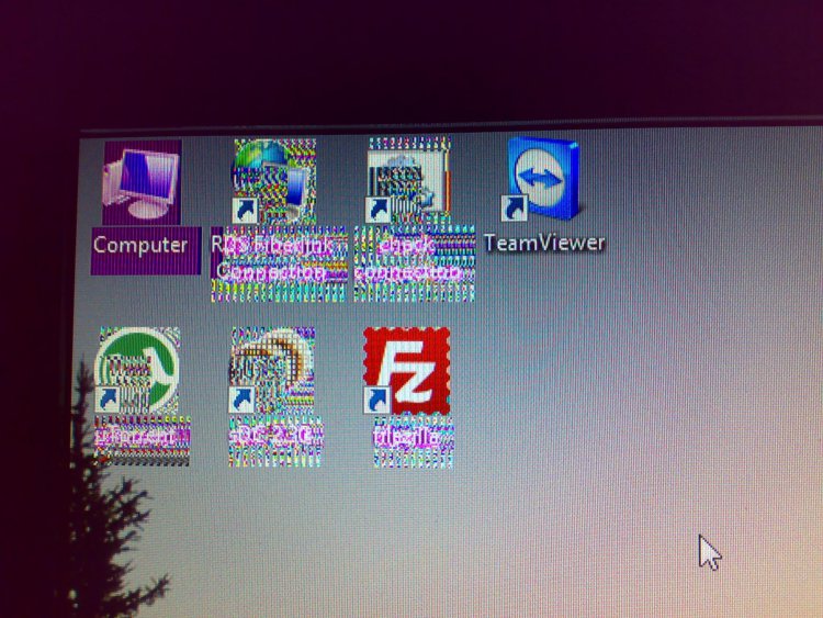

#2 - strange things happening to the desktop icons

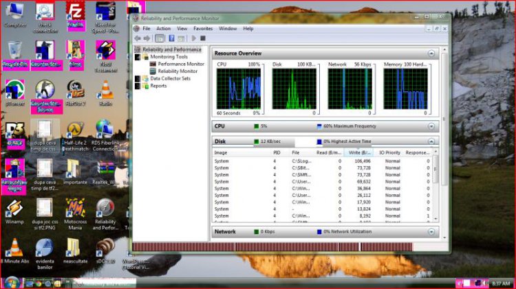

#3 - not only the icons, but the taskbar also (it's not usually red). the whole interface actually
#4 - resource monitor also goes crazy. you have to see it in a video

also i need to mention: after restart, system works ok for some time.
could it be ram's fault? processor? motherboard?

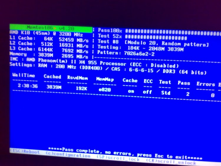

here's the result.
i took out the graphics card, then used the onboard graphics: after a while i've met the same problem, so i guess it's not the graphics card's fault.
then i ran memtest for about 2.5 hours, got no memory errors.
what should i do now?
i ran memtest with the onboard graphics (so it should have used some of the system's ram). should i put back my graphics card and run memtest again?
edit: why does it say 200mhz for my ram in the picture below? it should be 1600mhz...

last night i put back the graphics card and ran memtest again for more than 2 hours - again, got no memory error
