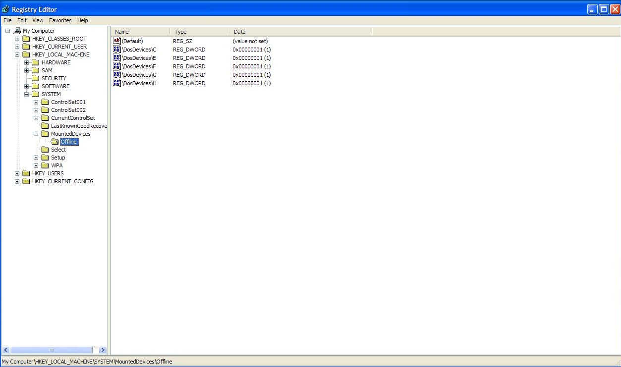

1. Open the Start Menu, click on My Computer to open it, then make note of the drive letter for the Vista and/or Windows 7 installation that you wan to prevent XP from seeing to prevent their restore points from being deleted.​
2. Open the Start Menu, click on Run to open it,, then type regedit and press Enter.​
3. In regedit, navigate to the location below. (see screenshot below)​
HKEY_LOCAL_MACHINE\SYSTEM\MountedDevices
4. To Stop XP from Deleting Restore Points
A) In the left pane, right click on MountedDevices and click on New and Key.​
NOTE: If you already have the Offline key under MountedDevices, then skip this step and go to step 4C. (see screenshot below step 4C )​
B) Type Offline and press Enter.​
C) In the right pane of Offline, right click on a empty area and click on New and DWORD Value. (see screenshot below)​
D) Type \DosDevices\D: and press Enter. (see screenshot below step 4F)​
NOTE: While in XP, if your Vista or Windows 7 is not showing as being on the D: drive in Computer, then substitute D: with the drive letter that it is shown to be on instead. For example, if it is shown to be on the E: drive, then type \DosDevices\E: instead. Repeat this step if you wish to hide another drive letter from XP.​
E) In the right pane, right click on \DosDevices\D: and click on Modify.​
F) Type 1, and click on OK. (see screenshot below)​
G) The registry should now look like this. (see screenshot below)​
H) Repeat steps 4C to 4G for any other drive letter that you want to prevent them from being seen by XP.​
I) Go to step 6.​
5. To Restore the Default XP Settings
A) In the right pane of Offline, right click on \DosDevices\D:, and click on Delete. (see screenshot below step 4H)​
B) Click on Yes to confirm the deletion.​
C) Repeat step 5 for any other listed drive letter that you would like XP to be able to see again.​
6. Restart XP to apply the changes.​

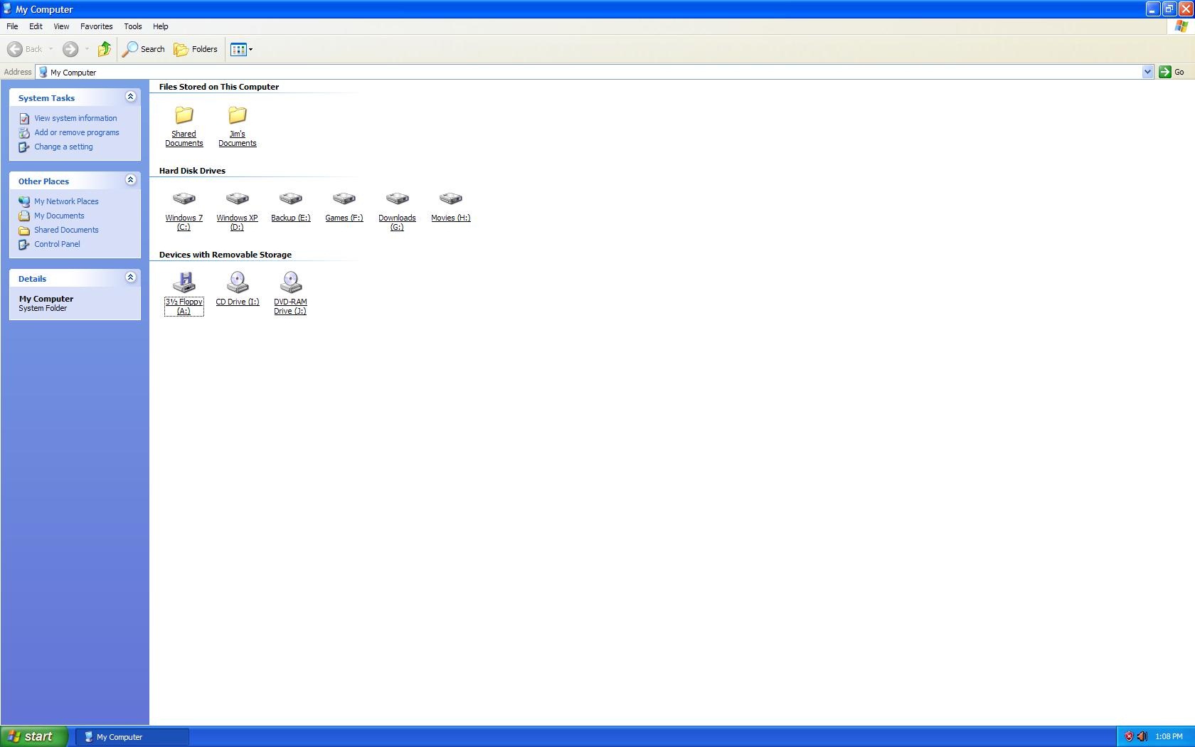

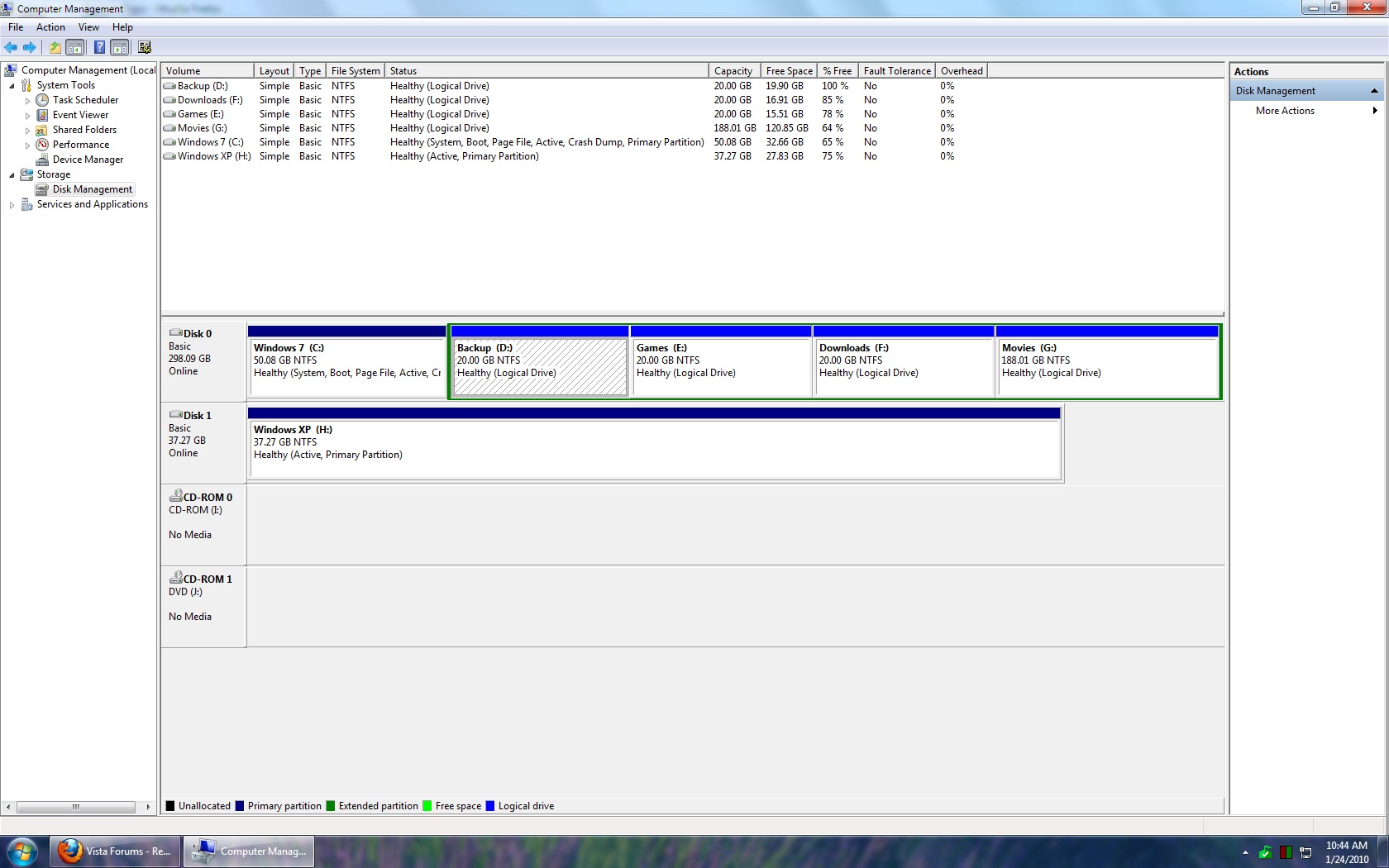

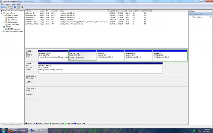

Hi Brink, Thanks to your excellent tutorials I decided to take the plunge and go dual boot with 7 and XP. Everything seems to be working well, except for XP deleting restore points in 7. 7 is installed in a primary partition on HD 1 along with 4 logical partitions in an extended partition. XP is installed in a primary partition on HD 2. I've done Option 2 with the registry edit, but can still access all the other partitions on HD 1. Any help you can give me would be most appreciated. Thank you. Jim

Hello Jim, and welcome to Vista Forums.
Double check to make sure that you did this in XP and not in Windows7, and that you used the correct drive letter of the Windows 7 drive as it shows in XP.
    Logitech MX Master 4
Yep, I did it in the XP registry. In 7 HD2 shows as H drive, while in XP it shows as D drive. I tried to stop XP from accessing any of the other partitions, with no luck so far. I even tried shutting off system restore in XP and 7, except for C drive in 7.

Jim,
It appears as Windows 7 was installed first, but how did you setup and install your dual boot? I'll see if I can do some testing using the same way you set it up to see what I can find.
Yes, 7 was installed first, then I installed XP on HD 2. After XP installed I booted into 7 by changing the boot order in the bios, ran EasyBCD 2.0, then booted into XP and tried Option 1, but that didn't seem to do anything, so I went with Option 2 and edited the registry. Hope that helps...

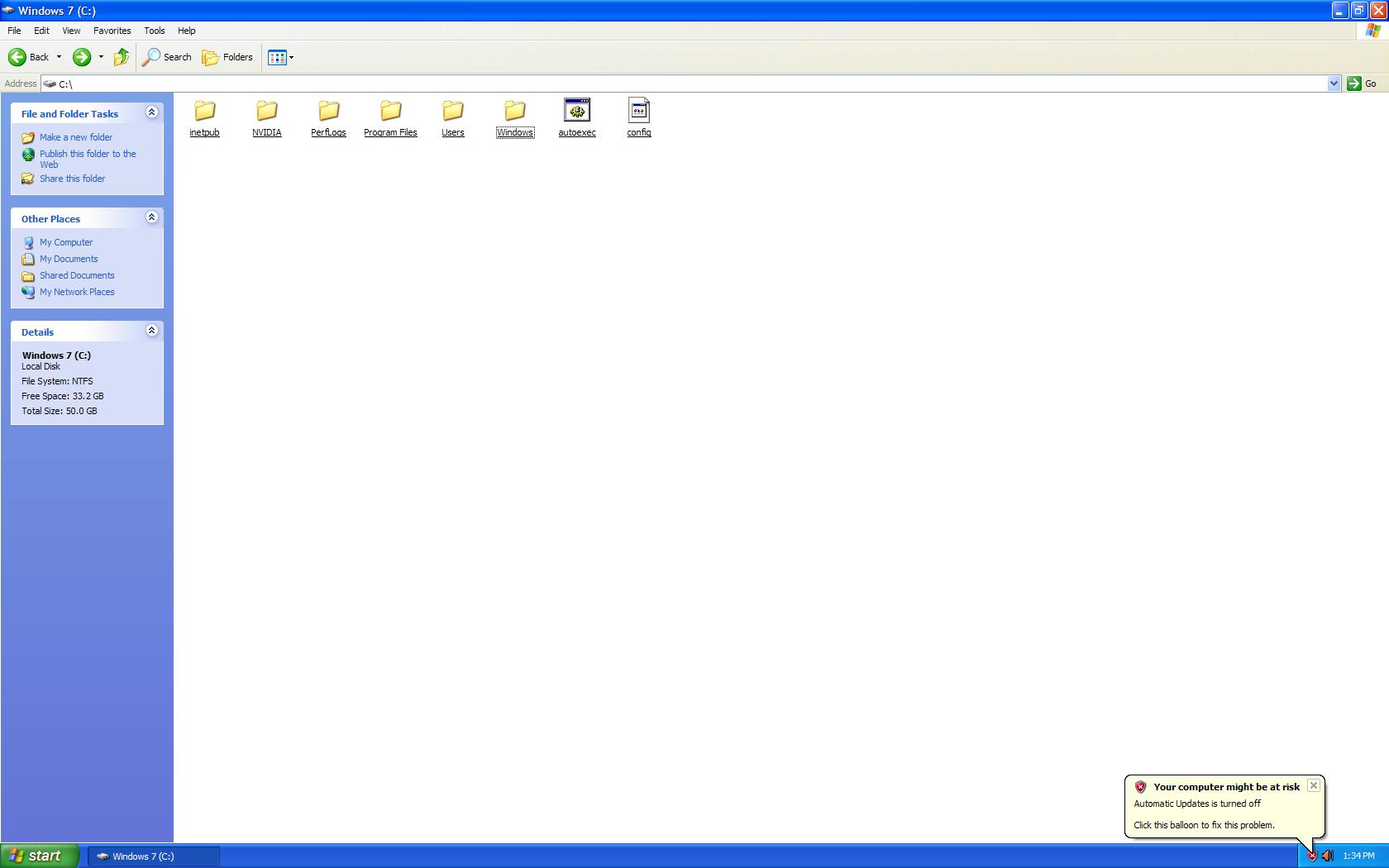

Ok Jim,
After some testing, I see that the Windows 7 C: drive letter will still show up in XP, but when you open it in XP's Computer window, it will just be blank and inaccessible after you used the tutorial to "Stop XP" from seeing it. Normally you would be able to open the Windows 7 drive letter and explorer it if it was not stopped in XP with this tutorial.

Well dang, I must be doing something wrong then. Not only can I open all the folders, I can also edit stuff in them..Maybe I should delete the registry entries and do them again.

Strange. Did you restart XP afterwards?
Yep, I've restarted XP many times since then. I did notice that indexing was enabled on all the drives, so I turned it off on every drive but XP. Don't know if that would do anything, but just in case...
I then deleted the registry entries, rebooted, entered them again, rebooted and...WOO HOO! :party:
I can see the drives, but they appear empty, just like you said they should. To make sure I booted into 7, created a restore, booted into XP, then booted back into 7 and it was still there.
I can't thank you enough for helping me sort this out. Whatever they're paying you, it ain't enough! ;)
