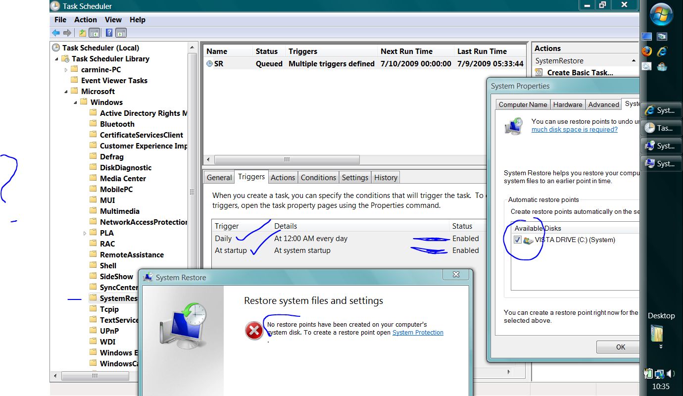

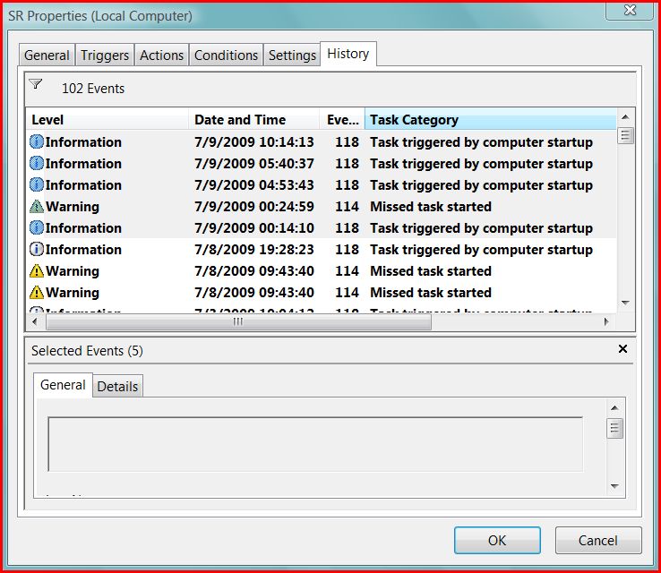

I setup the Task Scheduler according to your tutorial to create a couple of restore points each day. The Task Scheduler History tab tells me that the actions are being carried out as scheduled. However, when I check the System Restore listing of restore points that have been created, usually only one restore point each day is recorded there.
I have looked at all the options in the Task Scheduler to ensure that everything is enabled properly and all the Triggers are present and all looks good, and as I mentioned, the Task Scheduler History tab shows the scheduled actions are being carried out.
So, I'm curious, why am I not seeing all of the scheduled Restore Points in System Restore?
Hell Travelin, and welcome to Vista Forums.
Using these tasks, a system restore point will only be created when the task is scheduled if Vista detects a change in your system.
However, you can create a new task to run a program instead for when you like. The program can be the Create Instant Restore Point shortcut. It will create a new restore point everytime it runs, no matter if there was a change or not to your system.
Hello Shawn,
Thanks for the explanation. I assumed that using the Task Scheduler to create Restore Points would be the equivalent of manually creating a restore point. If I understand your reply correctly, the Task Scheduler will not actually create the restore point unless there is a change to the system, but, won't this happen after the change to the system, not before?
Paul
If you create a new task using the shortcut above, then it is the same as creating a restore point manually, but only having it done automatically for you instead by the new task.
The default System Restore tasks only create a restore point if it detects a change when that task runs at it's scheduled time. Yes, the change would have had to happen before the default tasks runs for it to create the restore point though. :)
Thanks, puzzling though. I thought the point of using the Task Scheduler to create restore points is to have restore points created on a schedule whether or not there have been changes to the system.
I am working on the shortcut you suggested, but my preference is to have the Task Scheduler automatically create restore points for me on a set schedule even if there are no changes to the system. From your reply, I guess that's not possible.
Thanks, Paul
